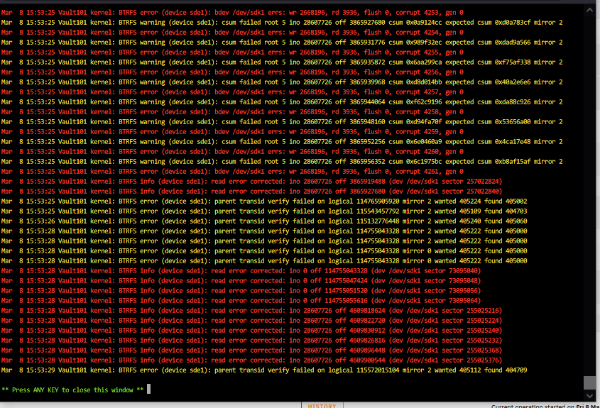

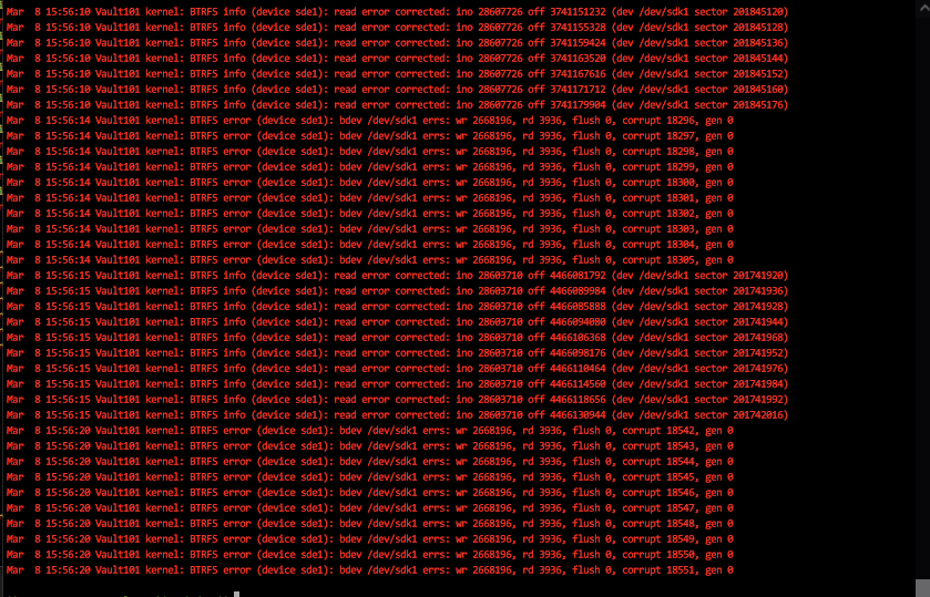

also checked disk logs and see the below
cache disk sde
cache 2 disk sdk
Also i have tried a different sata cable on the disks to see if it helps but to early to tell esscailly with the current errors parity check in process cause i rebooted it to get it to respond

So i have ran a scrub and it has gave me the following
UUID: 5f5d37ad-1efa-46da-b974-d876dfdb375a
Scrub started: Fri Mar 8 16:05:10 2024
Status: finished Duration: 0:43:16
Total to scrub: 142.90GiB
Rate: 56.34MiB/s
Error summary: verify=2592
csum=1678144
Corrected: 1680736
Uncorrectable: 0
Unverified: 0
is there an indication to why my cache has corrupted ?, i am am happy to move everything off my cache again to see how that goes cause it leaves corrupted stuff behide but looking for input before i do this incase there is a suggestion

Those errors suggest one of the ache devices dropped offline in the past, scrub brought it up to date, and since there aren't any uncorrectable errors it should be fine now, assuming no NOCOW shares.
It would be a good idea to check/replace cables for that device, the one that was /dev/sdk on those screenshots.
