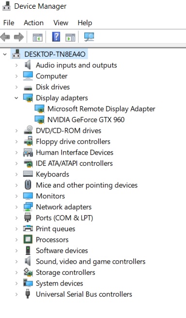

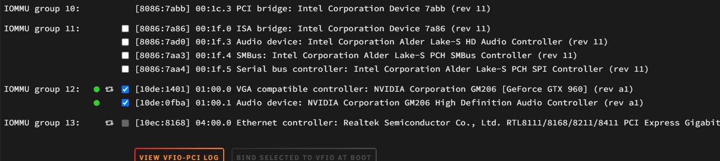

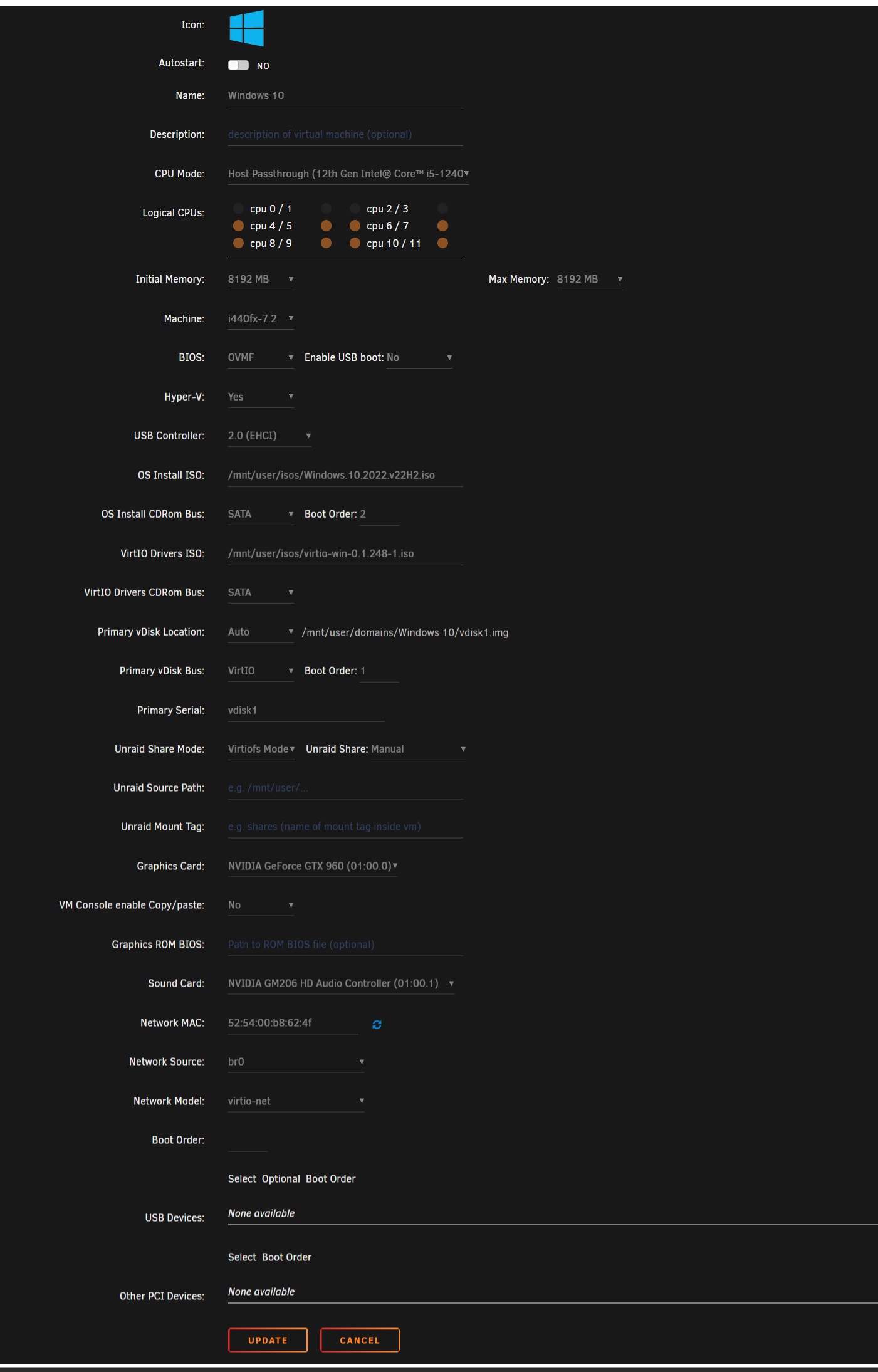

I have Unraid 6.12.8, Gpu NVIDIA GeForce GTX 960, I install Windows 10, follow SpaceInvaders tutorial. I access the VM through Remote Desktop Connection. And now I don't know if GPU Passthrough works for me.
Attach a monitor to it if you want hard proof. Your device manager shows no error so i assume all is fine.

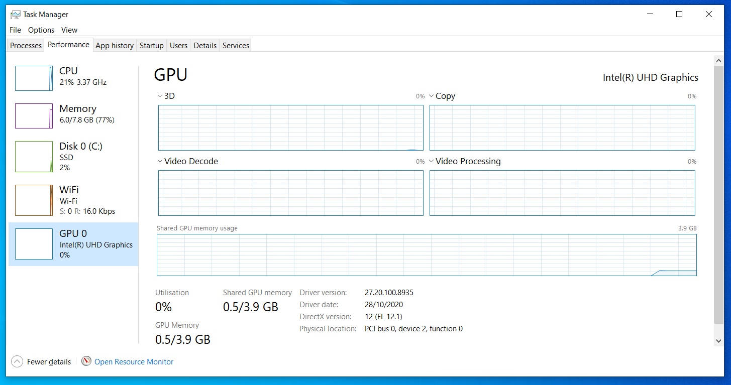

That last screenshot from the taskmanager... is taken from your pc/laptop or your vm? Because it shows wifi and Intel integrated graphics.
Congratulations on your observation. I pressing ctrl+alt+del and got the task manager from the laptop.

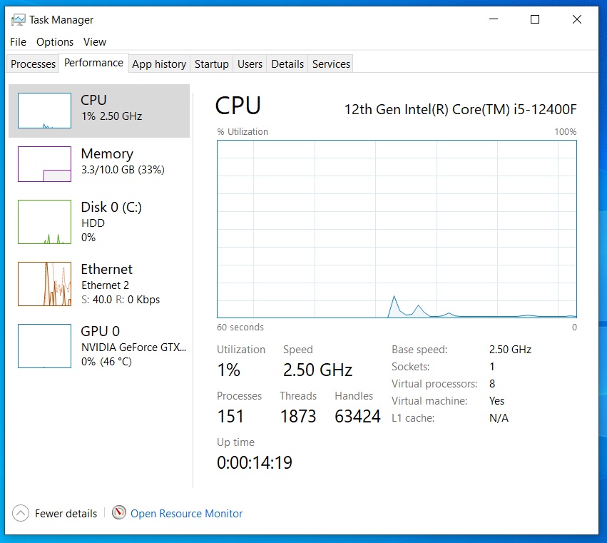

This is the task manager from VM.
Thx
