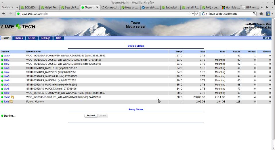

Can you post a screen of the webUI? Is it a single drive that won't mount or will none of the drives mount?

Btw here is the screenshot. The web interface is basically not responsive. But the server is still running (connected thro telnet)
