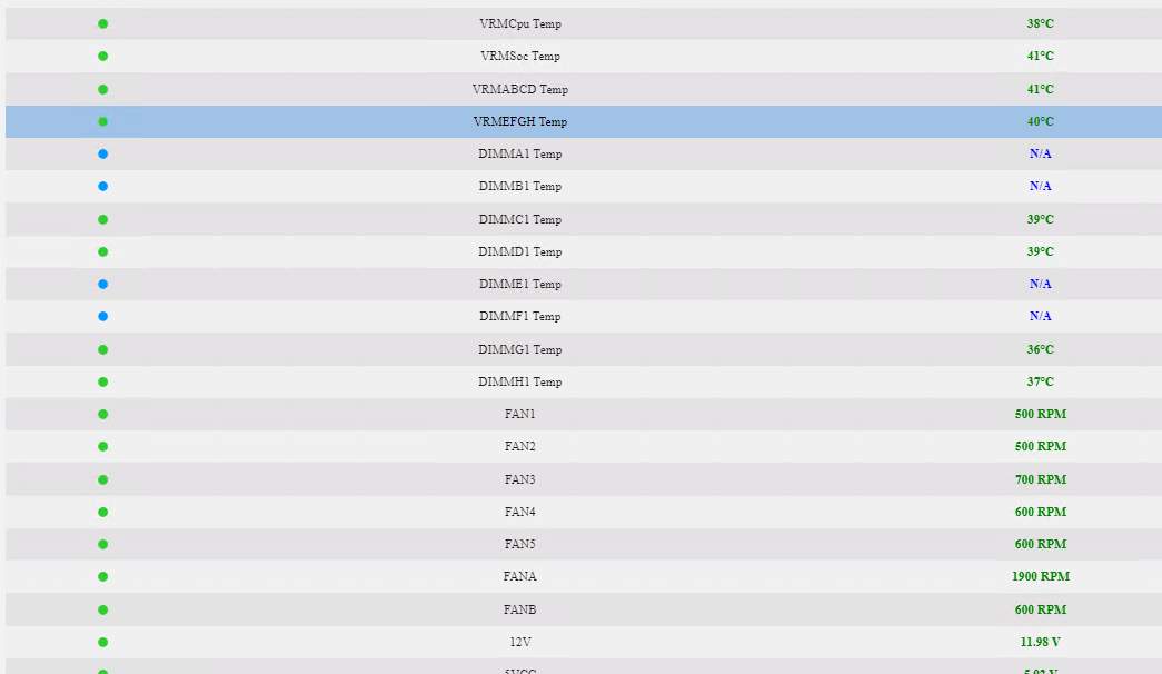

AFAIK non ECC RAM doesn't have a temp sensor, if you have a workstation/server board with ECC RAM and IPMI you can use the IPM plugin to see it there:
