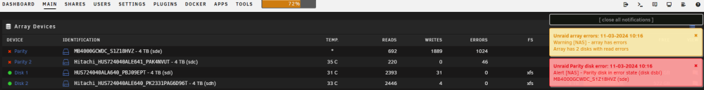

Saved, and I finally got to boot.  During the boot I noticed alot of "Power-On or Device Reset Occured" errors in the startup logs.  And sure enough, once the array came up, I noticed that a disk was missing.  I had to disks unassiged on standby, so I decided to just run a rebuild, and I would sort out the missing disk another day (Its late, I want my array up, and I am tired).
Well after about 5 minutes of waiting on "Array Starting, Mounting in Progress..." it came up, but now one of my Parity disks is also in disable state.  both disks are on the same HBA, so, I think there is an issue with the HBA.

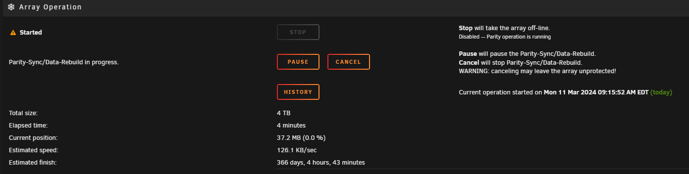

But I am also seeing incredibly slow parity.  around 1 MB/s.  I know the HBAs I have arent top of the line, but based on my math and research, I thought they would be faster than that.
What options do I have?  I know I need to check the HBA, but now with potentially a missing parity disk and a missing data disk, I am afraid to do anything.  I also dont like the idea of parity build running for 30 days!

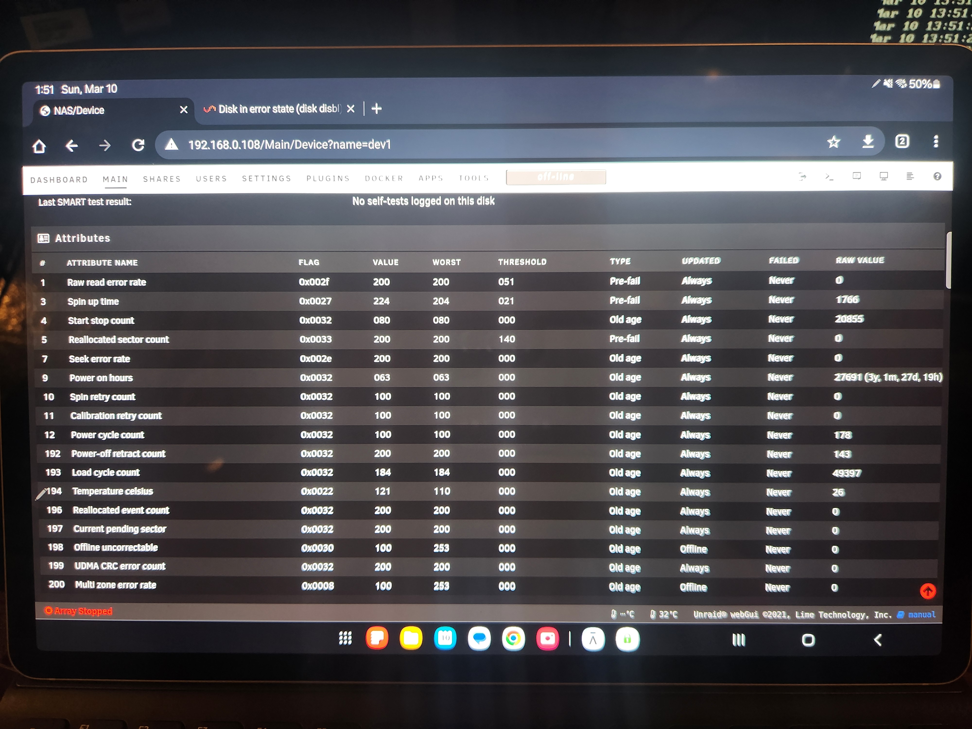

Update - my "good" parity disk is now failing with seek error rates.
Am I going to lose data?

Update again - P2 Seek error rates have disappeared.  If I check the drive details, it is no longer in a failing state, and seek error raw value is at 0 (it had climbed to like 31457.  I don't know what that means.

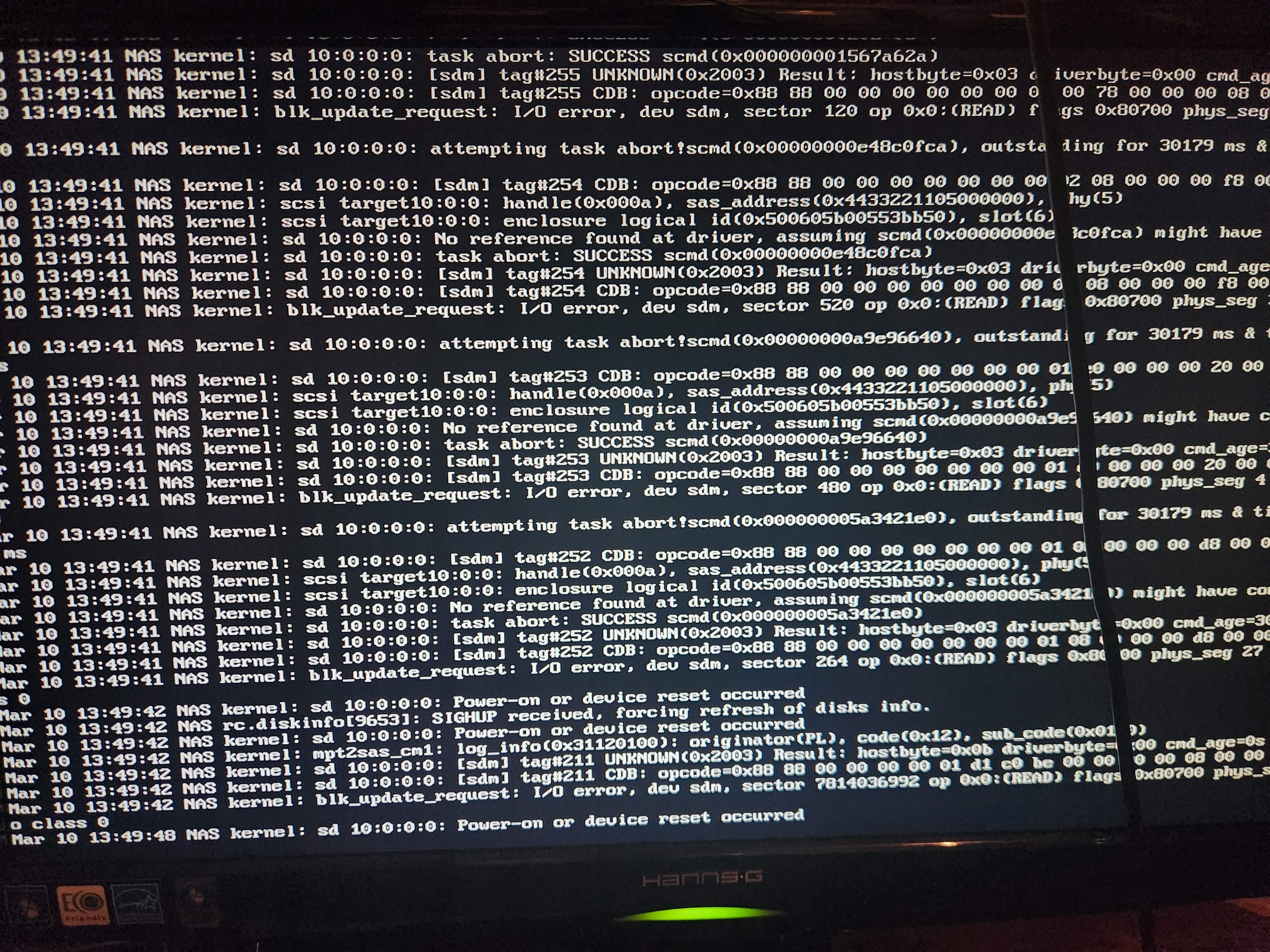

However. Tailing the log I am still seeing the power on error repeatedly for drive sdm. This drive is currently part of unassigned devices.
I am ready to rebuild the dsbled parity disk. Should I shut down and pull sdm before I start the parity build?
Latest diagnostics attached.

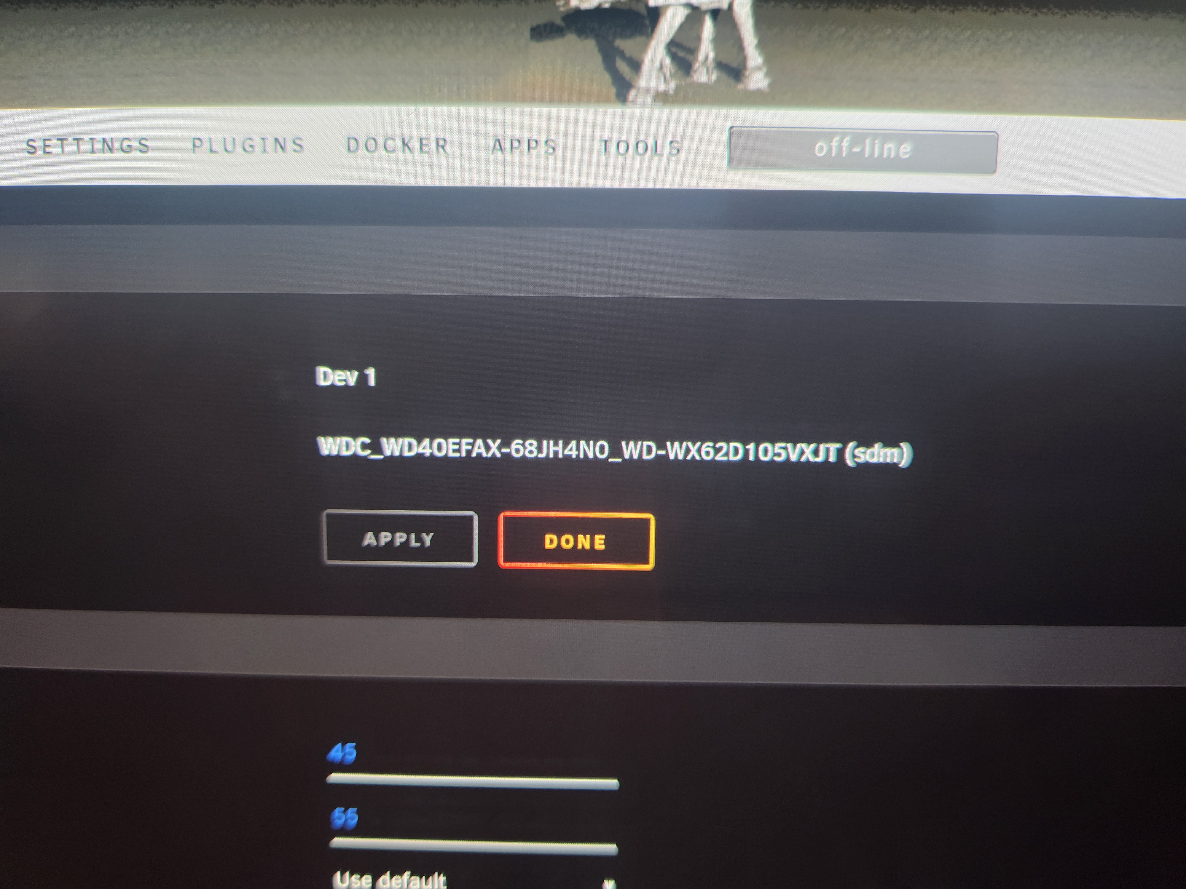

Screen shots of error on console and sdm smart report attached.

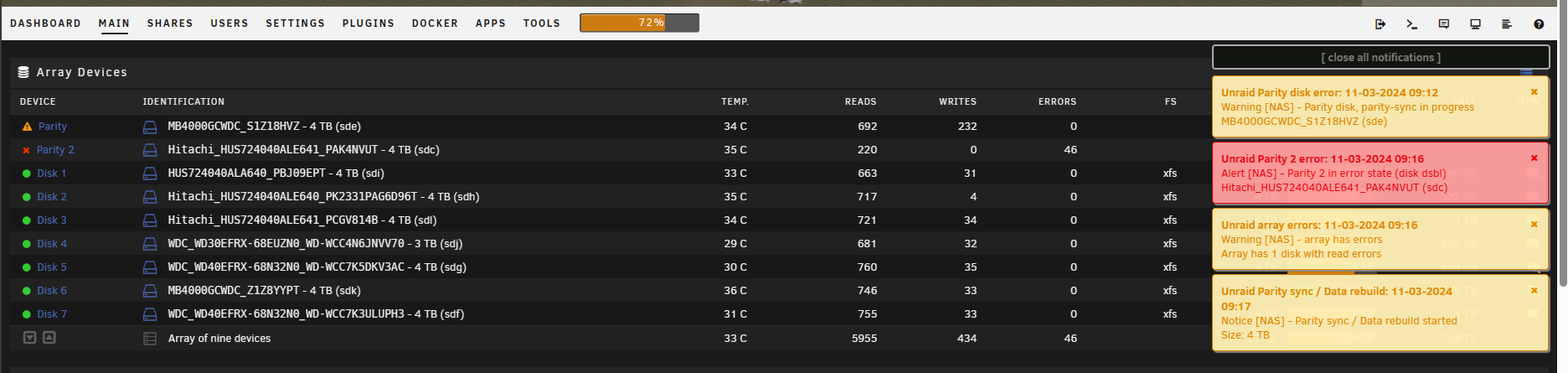

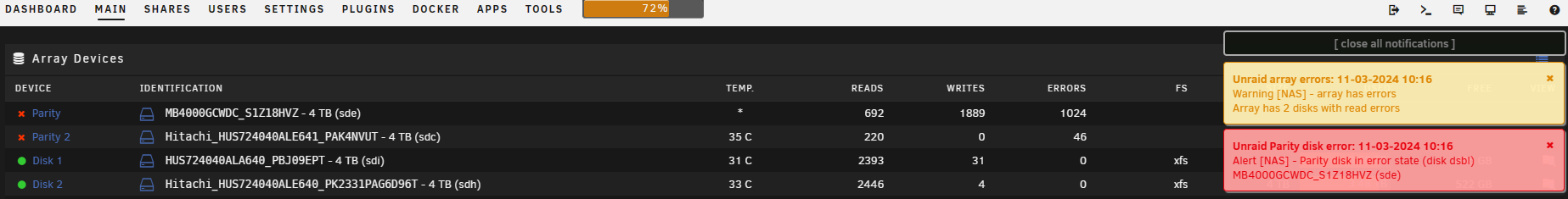

Things went from bad to worse.
I switched to brand new cables, pulled the disks that were throwing errors.  Restarted, tried to rebuild using a new disk from unassigned.
Now both my parity are in a bad state, and I am still seeing very slow rebuild times.  I do not know how to recover from here at this point...Both my parity disks were plugged directly into the motherboard.

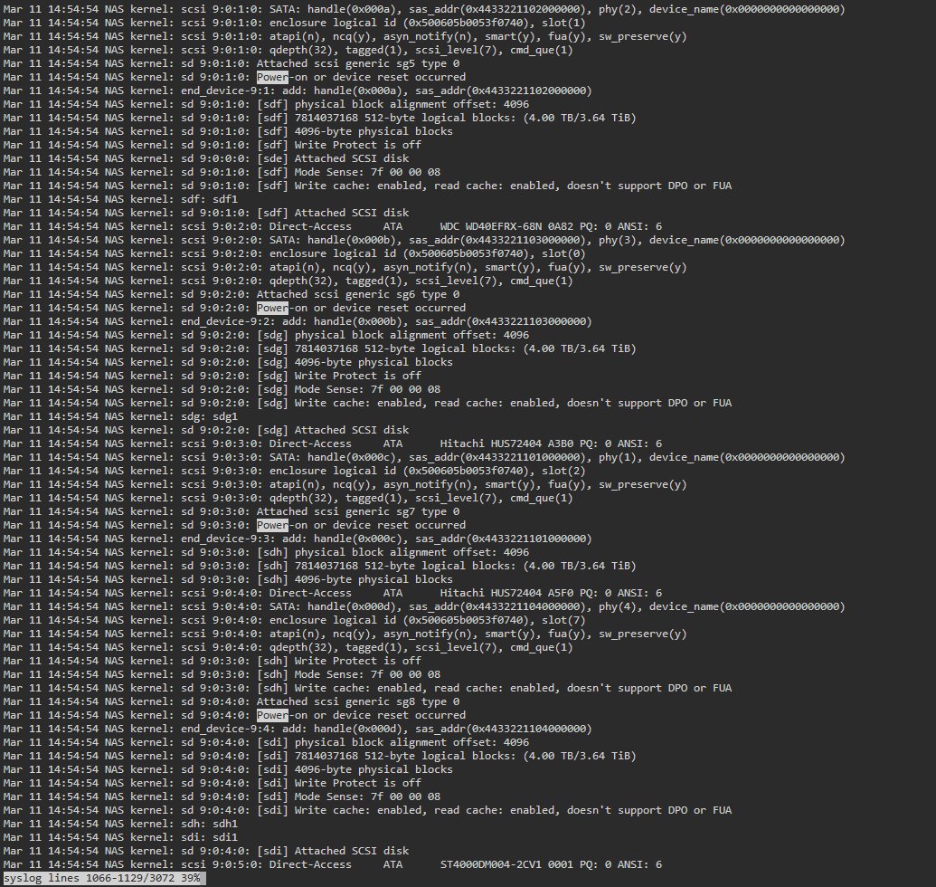

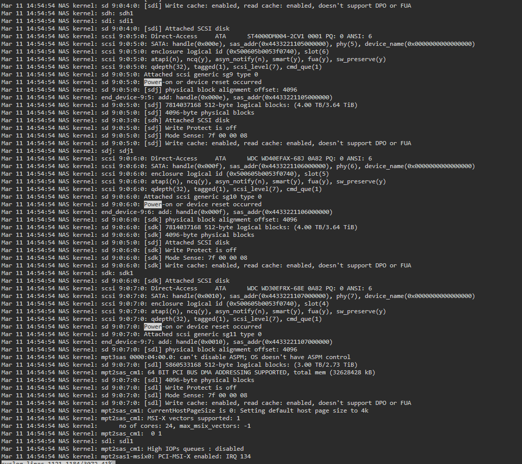

Mar 11 09:22:21 NAS kernel: sd 9:0:0:0: Power-on or device reset occurred
Mar 11 09:22:21 NAS kernel: sd 9:0:6:0: Power-on or device reset occurred
Mar 11 09:22:21 NAS kernel: sd 9:0:1:0: Power-on or device reset occurred
Mar 11 09:22:21 NAS kernel: sd 9:0:2:0: Power-on or device reset occurred
Mar 11 09:22:21 NAS kernel: sd 9:0:5:0: Power-on or device reset occurred
Mar 11 09:22:21 NAS kernel: sd 9:0:3:0: Power-on or device reset occurred
Mar 11 09:22:21 NAS kernel: sd 9:0:4:0: Power-on or device reset occurred
Still looks like a power/connection issue.

Disks both crashed during parity...
1 of them was plugged directly into a SATA port on the motherboard.  The other is plugged into an HBA.
I feel like the disks are bad?  Could that be the issue?  Or is it more likely power supply / cable related?
Im afraid to do anything now.  All my dockers are off and I am not writing anything to the array.  If I power down, and a drive comes up missing, Im no longer protected by Parity correct?  What is the safest way forward?
