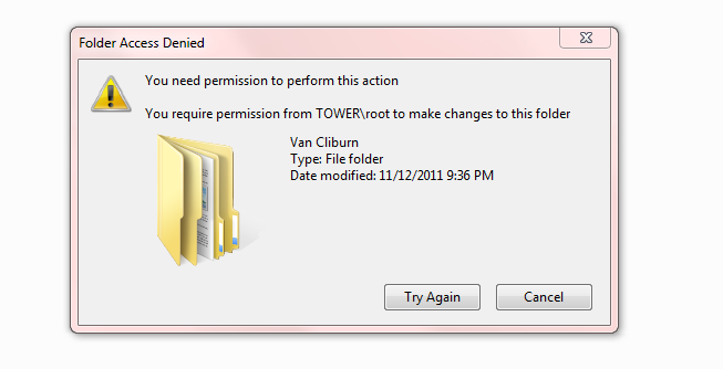

I have a problem which drives me crazy. I just added a second data drive, disk2 to my array.
Everything seems to work fine, no errors, drive 2 TB WD showed up properly. But I cannot write or
delete files or folders from my Win7 computer.
This only happened with disk2 (just added), with disk1 no problem ot R or W. I had tried for
hours on end with the user shares configuration to no avail. Export settings is set as R/W
and included disks as blank, disk1,disk2 all varieties of them. same results every times. I
can RW disk1 but not disk2.
Please help me. I have spent already 2 days adding this new WD 2 TB drive and now I cannot
use it.

I found out that the disk1 (problem free disk) has a FS reiserfs, while disk2 FS is unknown. So how do I fix this? I know that unraid used reiserfs file system FS. I did  preclear and it showed no errors . so I formatted and added to the array. I am pretty sure I messed up somewhere.
So something is making my disk2 as read only file system. How do I change this to read and write?
