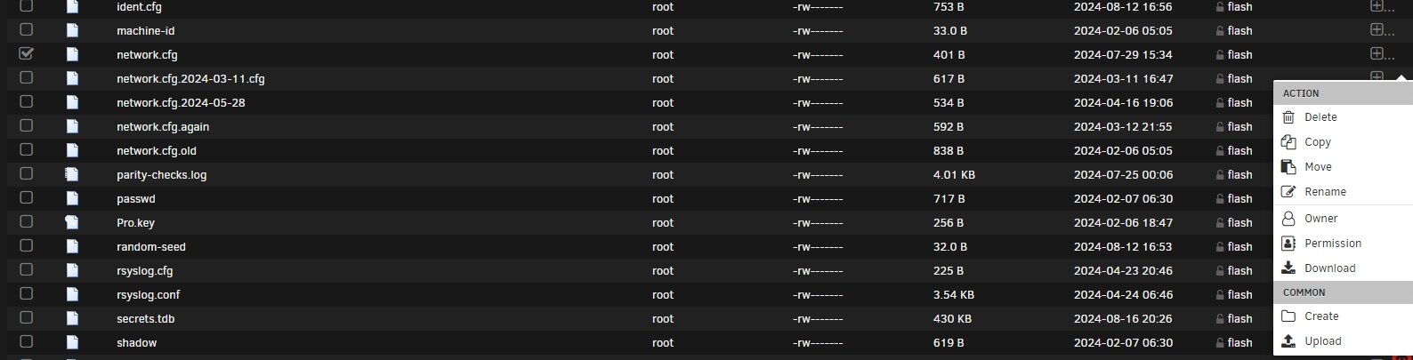

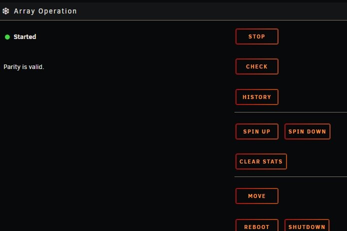

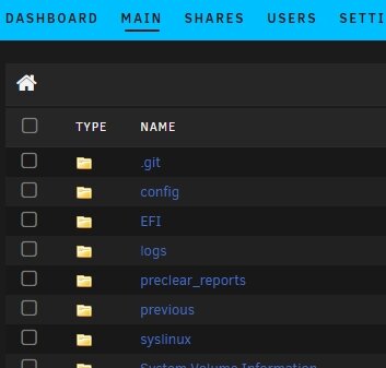

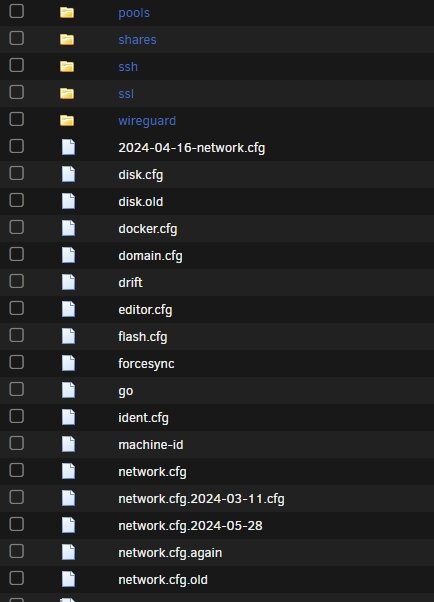

August 17, 20242 yr Author Hi Richard. Just follow the steps 1 to 4 as per pics below, then step 5 - navigate back to MAIN stop the array and reboot. The network configuration file will be auto recreated. I've found the issue often arises when multiple network interfaces are configured. HTH .. Dolf 1. Select the square with diagonal arrow on the far left of the Flash drive 2. Then click on the folder called config 3. Next, select the network.cfg file 4. Finally, rename the file or delete it 5. Stop the array and reboot. Edited August 17, 20242 yr by handycapp
