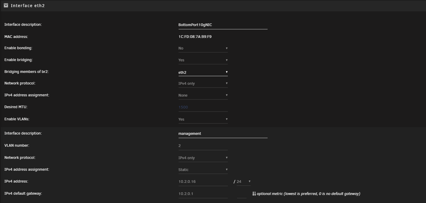

I believe I have setup the networking in unraid as I should.
Settings > Networking
I can reach the unraid server on that VLAN (2) as expected.
