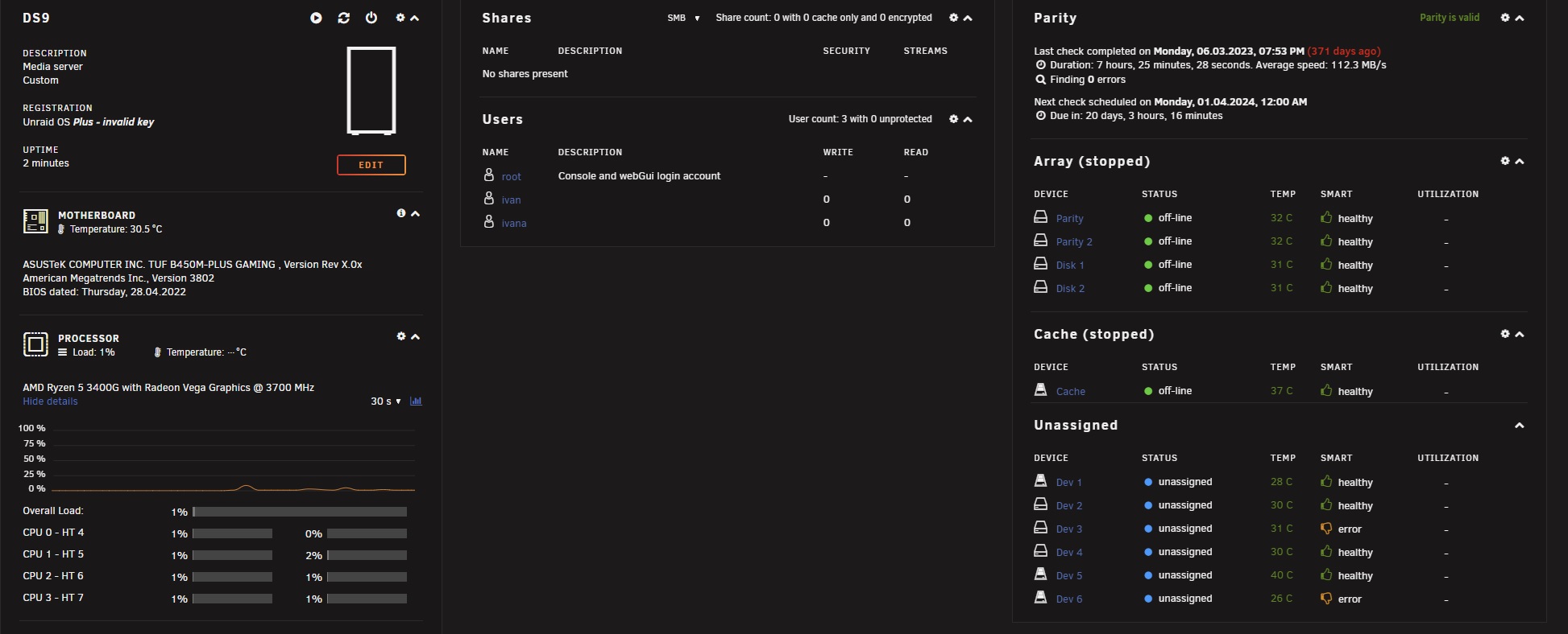

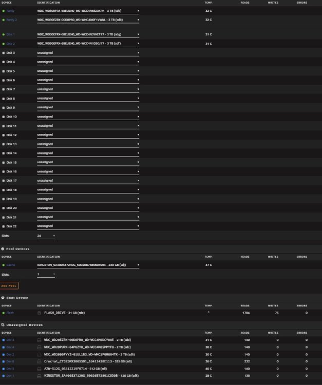

Hello everyone, been using unraid for some time now.
Today my flash drive failed, i had backup so i have flashed backup data to a new flash drive.
Backup was 4 months old, but i have not added any drives since or made any major changes.
After booting I can login without issues but my array is all messed up.
I have 4 OK drives and 6 unassigned ones (of which 2 are in error state, but they were ok before restore procedure).
Cache drive is set incorrectly (it is set to a 240 GB SSD and i had a flash pool of two 500 GB SSDs)
3 HDDs are unnasigned that were part of the array.
I dont care about cache now or two small SSDs (they were used for testing some VMs)
I want to restore my array. Is it possible now?
My super.dat from backup seems corrupted.
I am attaching 2 screenshots from the current state and my diagnostics.
Also my license is missing but I have it and believe I can restore it after i fix my array.
I would very much appreciate if someone could help me.
Thank you

Thank you for the reply.
I am sorry if it is a dumb question, but how will i know if the drive has a mountable file system or not? Follow step 3 or?
Because it says: Assign all drives as data drives, then start the array. Once it has started, make a note of the serial numbers of drives showing as unmountable as these are most likely our parity drives.
But if i start the array in an incorrect order would it result with data loss?
I am currently scared shitless about losing some of my data, i dont wanna do any wrong steps.
Not if all drives are assigned as data, the only danger is assigning a data drive to a parity slot.
If there's a used/free space stats in main it mounted, if not it will say "unmountable"
Thank you, i will try it
