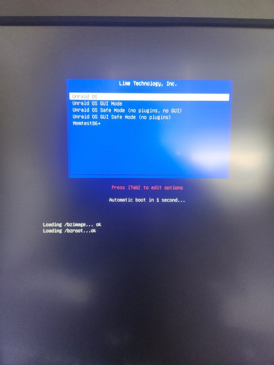

My flash drive seems to have failed last night. I created a new drive from a backup I had but the unraid is will not boot. It makes it to the unraid blue screen and it never goes past loading /bzimage...ok and loading /bzroot....ok.
It will reboot the computer over and over from that screen, I'm not sure what to do from this point, I didn't want to create a new image from scratch and have to figure out all the drive locations 20240311_130208.thumb.jpg.58b32366ed79a1cb6b923e1ba83cf408.jpg

Ran a mem test came back with no issues. Booted into a Windows USB just fine
Try using a different flash drive with a stock Unraid install, no key needed, just to see if it boots.
I ordered 2 new flash drives. They arrive tomorrow, I will write back updating status after I attempt the fresh drives.
Can confirm with a fresh install on a new drive Unraid will boot. I put my flash back up on the new drive and it will not boot it hangs at loading /bzroot.
Am i going to have to reinstall every docker and figure out all my drives or is there a way to recover some of this information?
Backup the current flash drive, install stock Unraid, confirm it boots, if yes restore the only /config folder from the backup.
Ok so that worked sort of. Unraid was able to boot, it was a little confusing since i had two keys and Unraids documentation on this is a little out of date but I got it working thank you once again JorgeB for all the help as usual!
