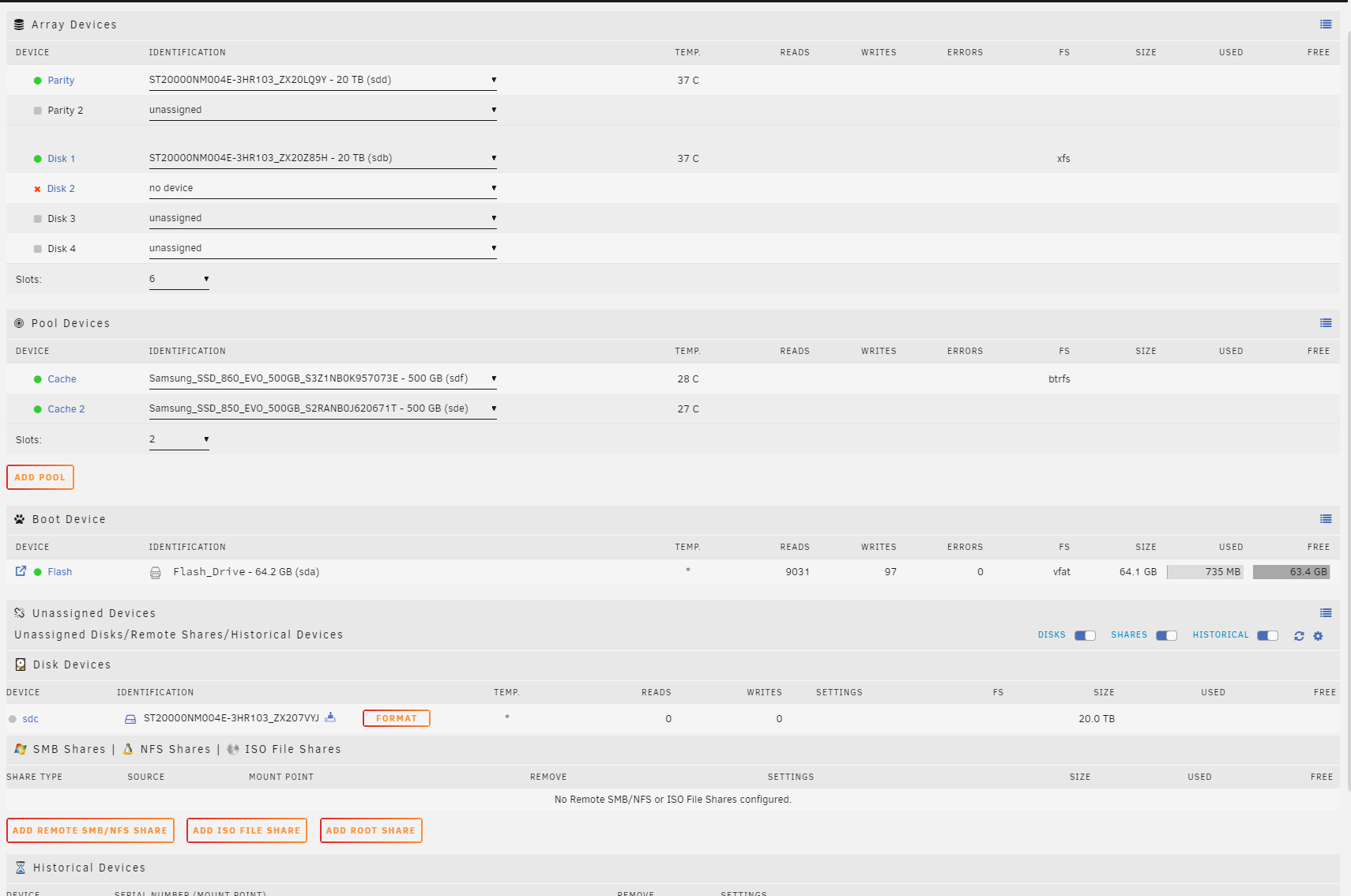

First time Unraid user, and after successfully installing my second data drive, it is now reading "Device is Disabled, Contents Emulated" in the array. I looked at my log (attached) and I have a ton of write errors. SMART info looks healthy (also attached). Am I fearing the worse that my drive is now dead?
I have yet to try any troubleshooting for this issue since I am still pretty new to Unraid and did not want to creat further issues

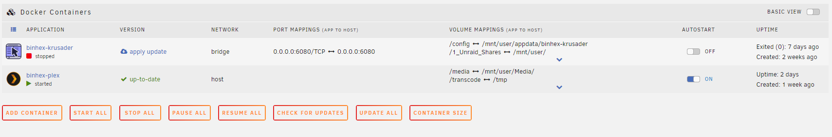

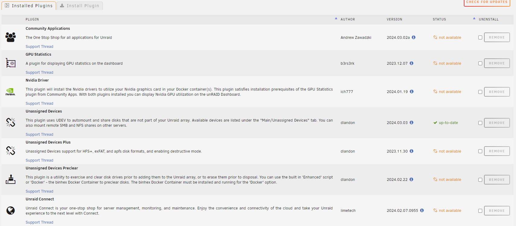

I have attached pictures of my plug ins and docker containers.

It's logged as a disk problem, and SMART is incomplete, so likely the disk is failing, but try swapping cables with a different disk and post new diags, to confirm SMART.
Still showing a bad SMART, you will need to replace it.
18 minutes ago, mastergamer1231 said:
Upon reboot the disk is asking to be reformatted.
Diags are with the array stopped, but if the emulated disk is unmountable check filesystem before rebuilding.
DO NOT FORMAT!!!
Start the array, with nothing assigned as disk2, in normal (not maintenance) mode, and post new diagnostics.
I will post more diagnostics when I get back home from work, thank you everyone!
Emulated disk2 is mounted so rebuild should be OK. Do you have a spare disk?
