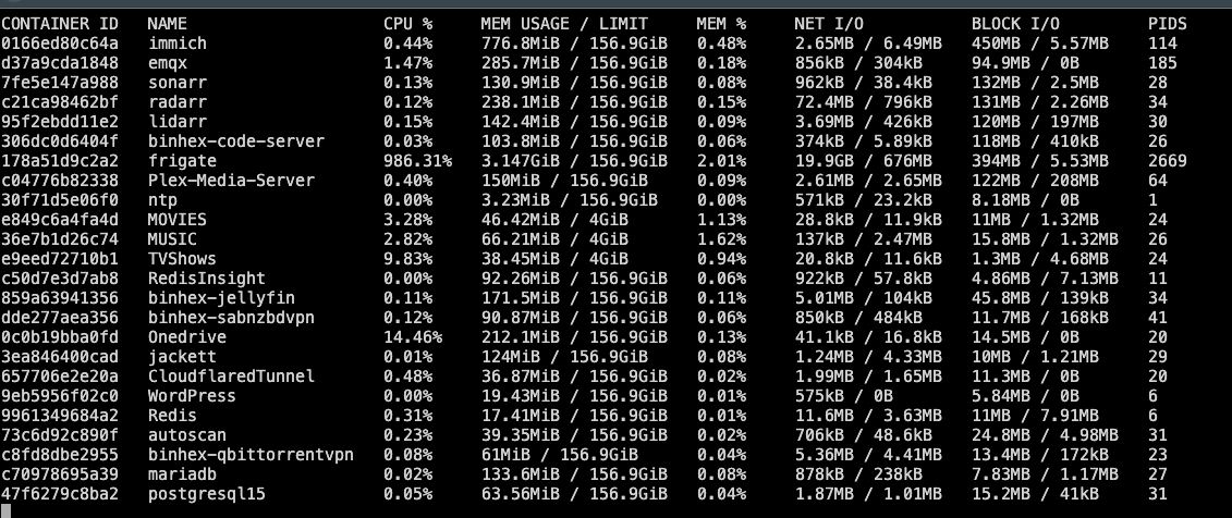

this is docker stats it looks like Frigate is is the issue
Thank you for the information, need todo more digging, any suggestions will be greatly appreciated...

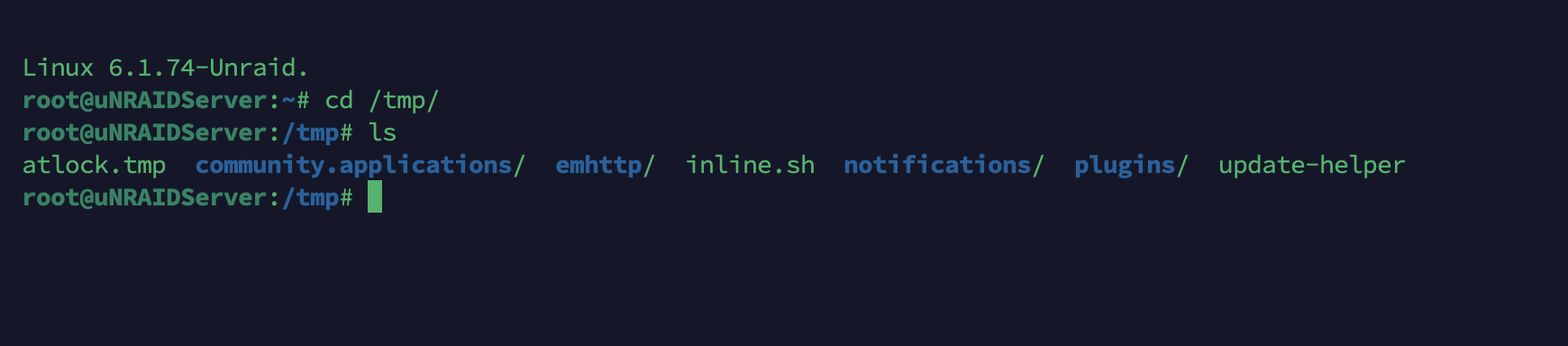

I'm not familiar with Frigate so I can't tell you where exactly to go, but in its settings or config file there should be storage folders and working folders, make sure that wherever ffmpeg is set to place its work files (which briefly looking at the docs appears it may be /tmp/cache) is either limited or mapped to a disk folder
I check on unraid the directory /tmp/ and don't see a cache directory image.thumb.png.0d5d9d0835b1aeeb4048a359e59927b2.png
Since you have not mapped it to a location outside the container this path is only internal to the container.

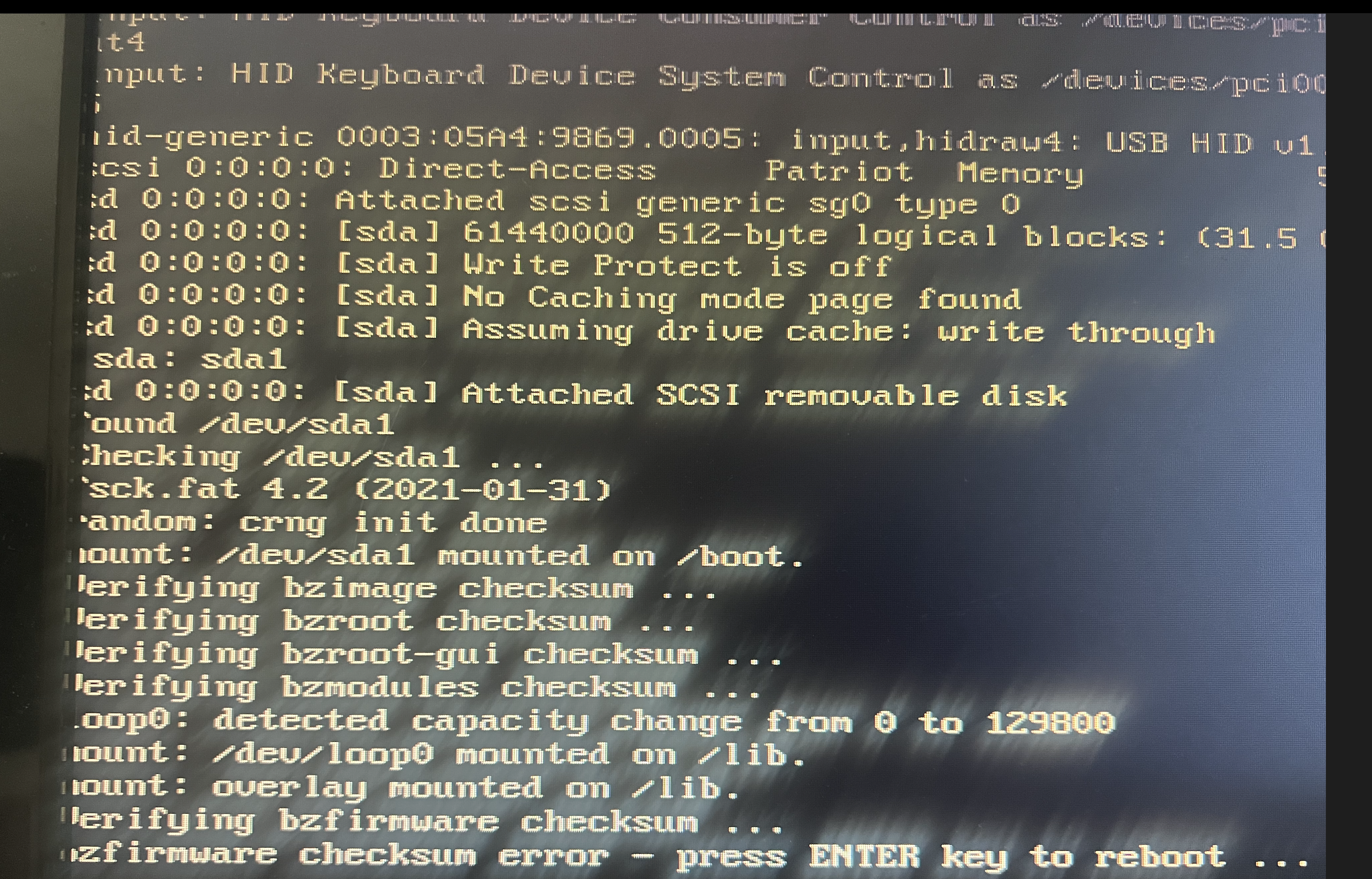

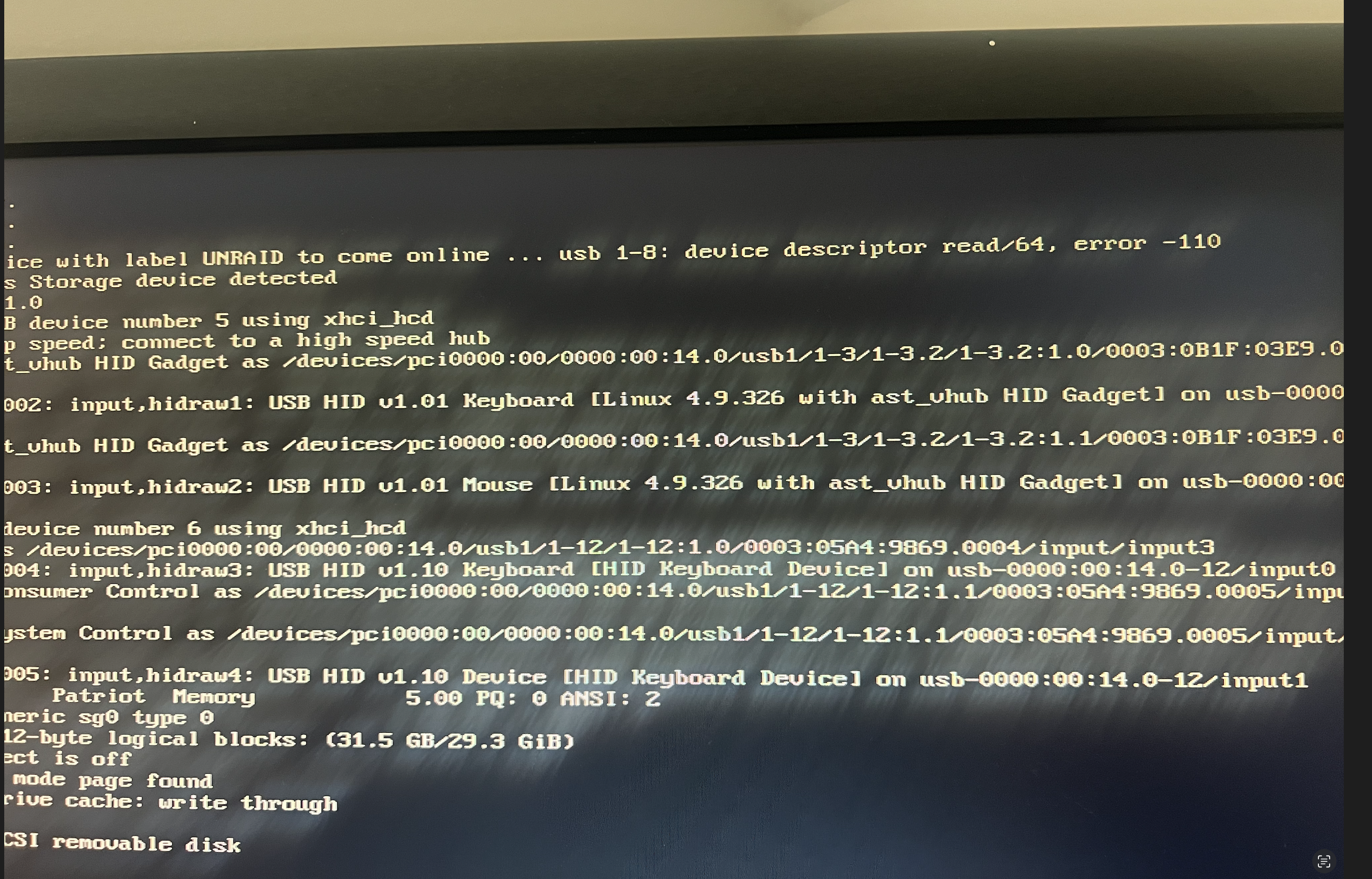

Now I have a bigger problem
I decided to rebuilt the USB so I formated and created a new USB and the server is not booting up Getting error 110
image.thumb.png.faa21f0035875a14df7be8ae7129f309.pngimage.thumb.png.c4e1260dfcc7b731391053da632541db.png
IMG_3326.HEIC
4 minutes ago, LugoCloud said:
Getting error 110
try another port, or retry creating the USB

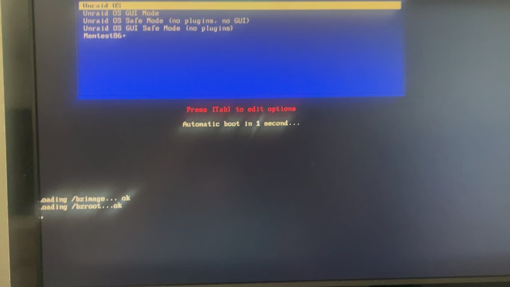

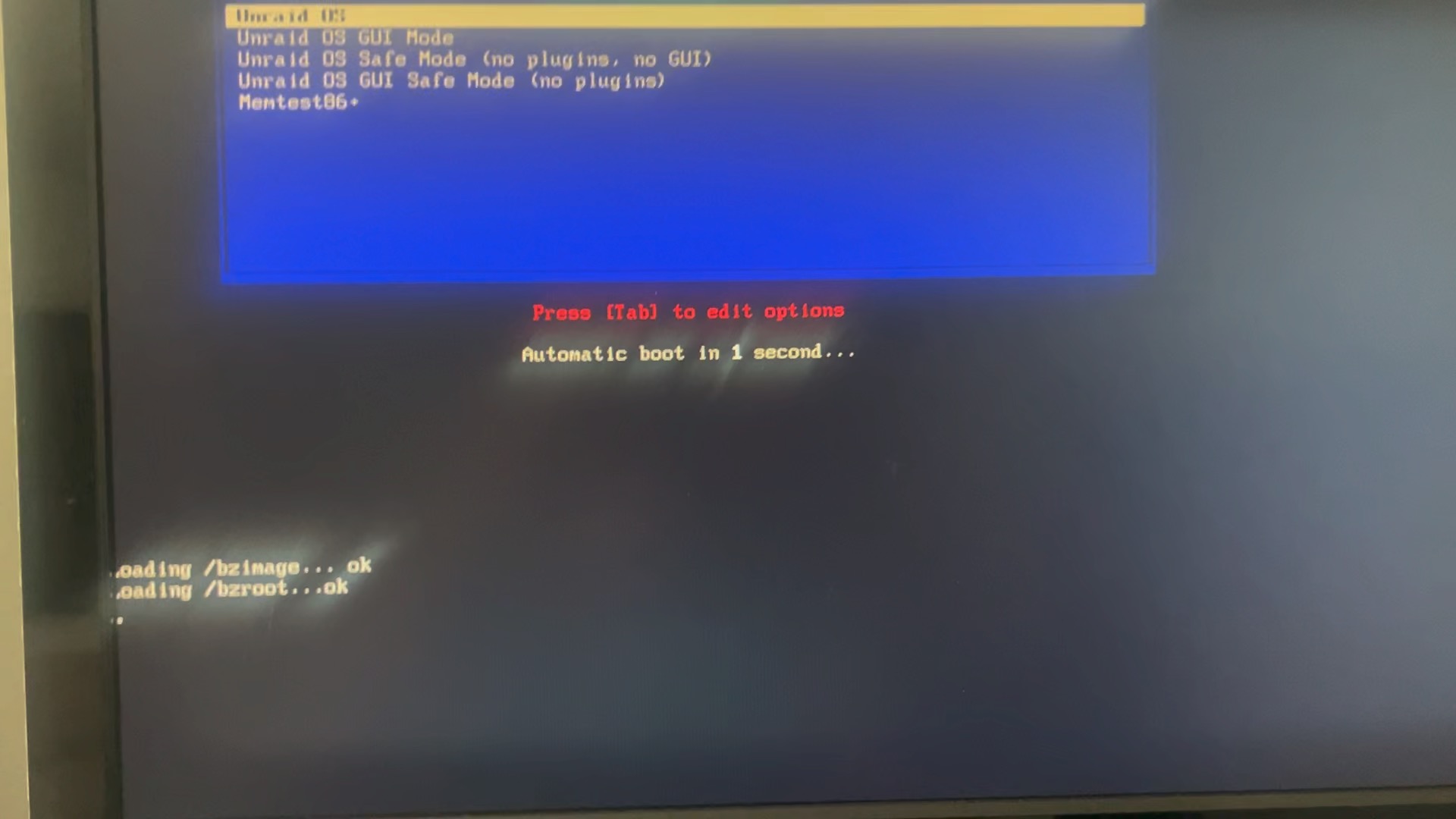

Now after creating the USB agin it just hang on bzroot ok
I also tried to boot on savemode and it pass the bzroot ok and it hangs on bzroot-gui ok its been there for 10 minutes or so
