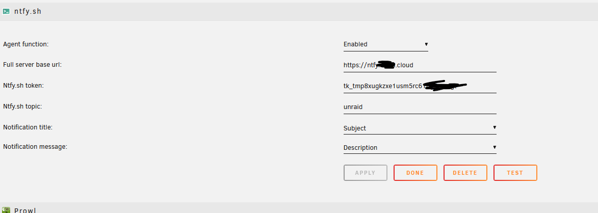

Ntfy notification agent is not working
My Ntfy server is docker container.
Everything works fine except notification from Unraid, nothing is send when I use TEST button
This is my config:
