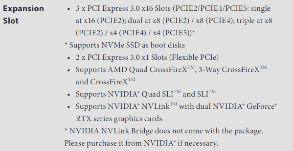

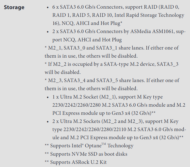

My issue seems like a PCIE lane issue but according to the mobo manual, my configuration should work as installed.  For added context I also have (3) M.2 drives installed, but again, the manual says those share lanes with the sata drives, not PCIE.
I've added the relevant snips from the manual below. Am I reading this wrong?
Configuration that is causing the issue is as follows. If I remove the GPU it works without issue.
PCIE1 - 2.5gbs network card
PCIE2 - 3070 gpu
PCIE3 - Empty
PCIE4 - LSI 9300-8i HBA
PCIE5 - Empty
M2_1 - 1TB M.2
M2_2 - 1TB M.2
M2_3 - 1TB M.2
