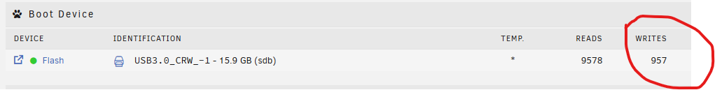

First, have a look at the WRITES to your USB drive.  You can find them here:
USB drives are not design for large numbers of write cycles.  The write count for this drive is over a 33 day period.  If your boot drives has substantial numbers of writes per day (say more than 200 per day) , figure out what is causing them.  You can post back here if you can't figure it out.

Thank you Frank.  Appreciate the help.

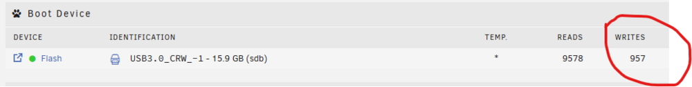

This is what my boot devices says right now:
My current up time is 24 hours.  Clearly more than the 200 per day.
I don't know how to figure out what is writing to it so yes, if you can give me some guidance there I would be very grateful.

Twenty four hours following a reboot may not be completely typical of normal operations.  Keep a eye on it for the next several days
Thanks again for your help.  I will do as you suggest and keep an eye on it.  It's at 4069 right now so maybe it was just the boot reads.
