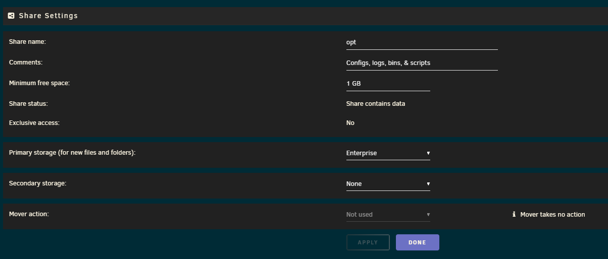

One share (opt) won't move to exclusive mode. I have a number of exclusive shares working so I don't believe this is a configuration issue. This share I previously had on the array only. I wanted to move it to be exclusive, so I:
  1. Switched primary storage to one of my SSD pools
  2. Set secondary storage to the array
  3. Set mover to move from array to the pool
  4. Disabled NFS export on the share
  5. Verified there is no content from this share `opt` on any other location by doing a `ls /mnt/*/opt`
The results are as such, but exclusive mode isn't flipping to yes. Are there any other ways to trigger it? Thank you.

Try removing the NFS options:
shareExportNFSFsid="101"
shareSecurityNFS="private"
shareHostListNFS="10.0.20.15/32(sec=sys,rw,insecure,anongid=100,anonuid=99,no_root_squash)"
I removed the options and set it to public, reenabled the share export, then disabled it again - unfortunately it's still not showing as exclusive.
Post new diags
Everything looks good, did you re-start the array after disabling NFS export?
I didn't, I'm in the middle of my initial parity calculation still. I can do that possibly in 24 hours.
That should resolve the issue.
@JorgeB Rebooting did not resolve this. I verified there is still only content for the share showing on the one pool and in `/mnt/user` but no `/mnt/diskx` locations. Should I post diags? I imagine they would be the same as yesterday?
Not sure why, but after a second reboot while NFS is off and everywhere on the array was empty, it turned on this time! Thanks.
