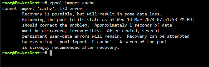

Post the output of:
zpool import
type
zpool import -F cache
if successful then type
zpool export cache
After that it should be mountable with UD or Unraid as a pool, and run a scrub.
That worked. Thank you! One last thing, if you don't mind. Since the drive was "repaired", I went and installed an old backup onto the USB Stick, but I still can't get to the GUI.
