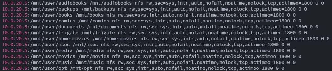

I am able to successfully export an exclusive share over NFS (v3 only) when sharing is not enabled upon array start, and then I subsequently enable NFS sharing on that share. It works fine. My fstab record on my client specifies NFS v4.2, but it then keeps trying lower versions until it successfully mounts with NFS v3.
The issue is that shares do not retain that exclusive status if I do not remove sharing prior to restarting the array, which is annoying, but not insurmountable.

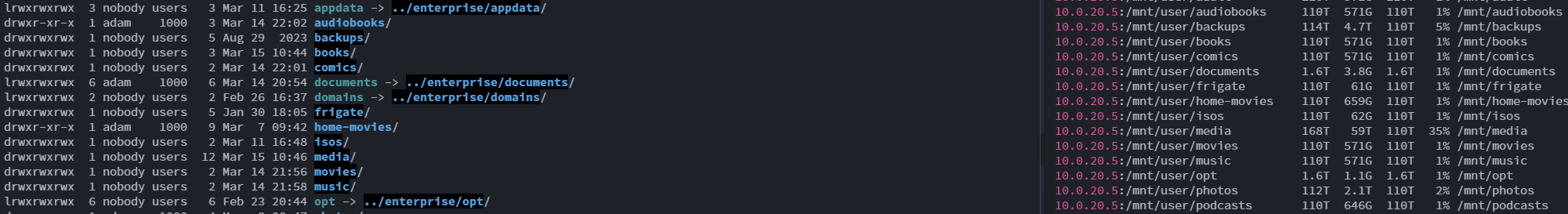

This logically makes sense. I'm not sure I understand *why* this is a limitation, then? There is no problem exporting a symlinked location via NFS?
I don't remember what the problem was exactly, but I believe there was an issue with symlinks over NFS, so NFS cannot be enabled for exclusive shares to work.
