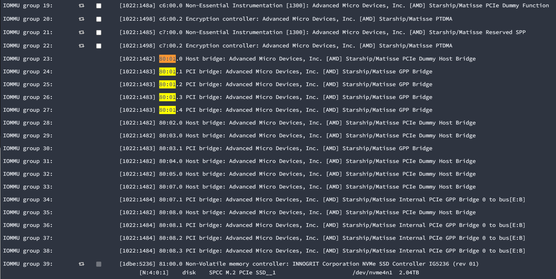

Any idea how to track the root cause of the issue? Is this complaining about PCIe slots? If so, which one?
This is what the system device 80:01.x is:
The motherboard is an ASRock ROMED8-2T.

Thanks, that seem to do the trick!
