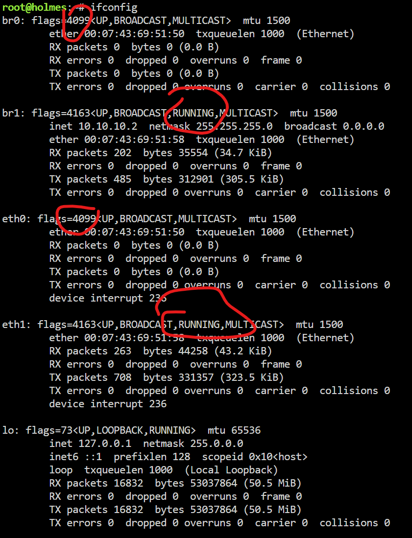

So yesterday was an adventurous day where I probably made more changes at once than I should have.
1) Changed firewall:  Untangle -> opnsense w/ zenarmor and surciata
2) Changed the host name of the servers
3) Changed the static dhcp ip for the server
I have 2 unraid servers configured very similar, both of them same subnet, same changes to both, etc.  I have direct 10g wire between them as well and they both use the same make/model 10g card (chelsio)
1 servers behaved exactly as expected (no issues) with the changes.   Works and accessible just as it was before.
The other server, no matter what I do, the interface will not pick up an IP address.  I can hardcode an IP and it takes it, but it doesn't look like the interface is active....and no matter what I do, I can not access it via the GUI except when connected directly to the server.
When I try to ping the gateway, I get the network is unreachable.
I can ssh between the servers via the direct link, but those are static ip's and it sets it up correctly everytime.
I changed the static dhcp entry on the firewall to a different IP in case it was somehow used already.
I tried removing the static dhcp and just have one assigned.
I've tried removing the network.cfg file
I've tried updating it with default values using this post:
One thing I have noticed that stays consistent is never changes from having a flag of 4099 and never shows RUNNING on br0/eth0.  Comparing it to the other server, it should be 4163 and show RUNNING.
Additionally, at the end of the eth0 entry is an error "device interrupt 236", originally it was 140, I don't know if the change is progress.  Comparing to the other server, I do know it shouldn't be there.
Scouring the web, I cannot find any information on the 140 or 236 interrupt's or even a hint at what they might mean.
I did find the flags are decimal versions of some hex values reflecting card settings, but none on how to control/change those values.
No matter what I do I can't get it working...at this point I haven't the foggiest idea on what to try or look at next.
I'm hoping somebody can shed some light my way...
I have attached diagnostics.

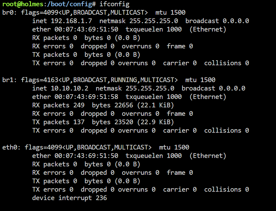

Here is the network.cfg I just rebooted with:
# Generated settings:
IFNAME[0]="br0"
DHCP_KEEPRESOLV="no"
DHCP6_KEEPRESOLV="no"
DNS_SERVER1="192.168.1.1"
BRNAME[0]="br0"
BRNICS[0]="eth0"
BRSTP[0]="no"
BRFD[0]="0"
PROTOCOL[0]="ipv4"
USE_DHCP[0]="no"
IPADDR[0]="192.168.1.7"
NETMASK[0]="255.255.255.0"
GATEWAY[0]="192.168.1.1"
METRIC[0]="1"
IFNAME[1]="br1"
BRNAME[1]="br1"
BRSTP[1]="no"
BRFD[1]="0"
BRNICS[1]="eth1"
PROTOCOL[1]="ipv4"
USE_DHCP[1]="no"
IPADDR[1]="10.10.10.2"
NETMASK[1]="255.255.255.0"
SYSNICS="2"

I noticed that your eth0 doesn't state RUNNING, mine does.
Is eth0 the port for direct connection between servers?
What happens if you remove the direct cable between servers and just have each one connect via the switch?
2 ports on each server.   1 port on each server going to switch, 1 port direct connect to the other server (static IP, different subnet)
Why a direct connection?  Lots of data moving back and forth between them, keeps the traffic off the switch, is a good deal faster.....plus, I had nothing else to do with the ports 🙂
eth1 is the direct connect with the other server, and yes, I noticed eth0 was missing the "RUNNING" piece (I posted a screenshot and talked about it in the first post)
This next question actually didn't have anything to do with the problem, but it put me in a position to see the problem!! (I'm such an idiot)
What happens when I remove the direct connect?
I hadn't even thought to try that since I wasn't having an issue with that port, so I was going to give it a shot, I had nothing to lose.
I went to the server and traced both cables coming out to make sure I was going to pull the right one.  I had gone over the cables many, many times over the last couple of days, verifying where they were going and reseating the connections on both ends....but it never sunk in and clicked.
It wasn't going into the switch, it was going directly to the spare port on my opnsense server.  A few months ago, I moved it from the switch to the spare port.  It had been in the switch for a couple of years, so it was ingrained in my head that it was connected to the switch regardless of what my eyes were telling me.
When I was running untangle I had bridged the interfaces so it was all the same network/subnet.   When I moved to opnsense on Saturday, I completely forgot about the creating the bridge....even though I had a screenshot of the old setup showing the bridge.
Not only did I not bridge the interface, but I also disabled it.  So there was no way the server was going to be talking to anybody from that port.
Once I recreated the bridge, everything worked as expected.   I just had to go through and undo all the changes in unraid I made during troubleshooting.
So long story, short, Thanks for the nudge!!....I was finally able to sleep peacefully 🙂
