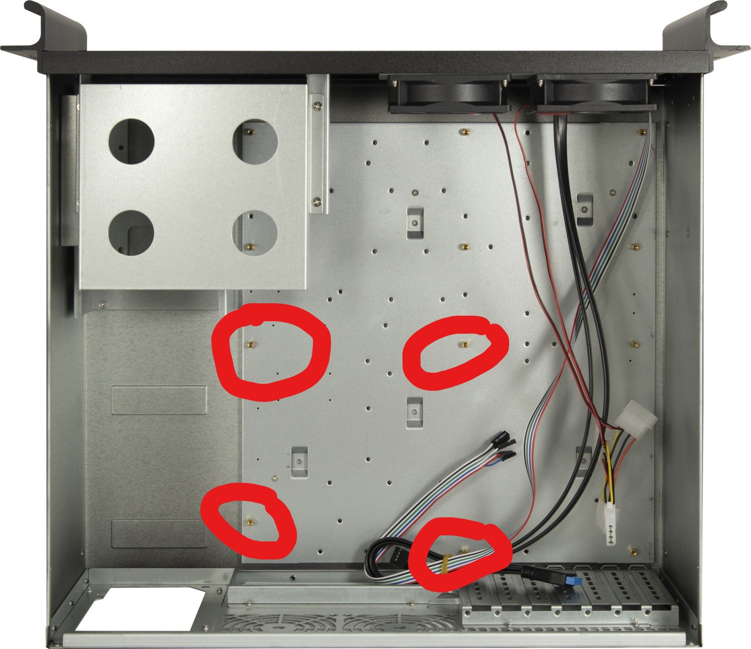

Hello, what do you have in mind? almost all 19" Rackcases can house an ITX mainboard. If not extra stated in the specs the four screw holes in the IO area are the ITX standart spaces. With you CPU cooler i would recomend not smaler than 2U in high. like this one https://geizhals.eu/inter-tech-2u-20255-88887105-a1188043.html?hloc=at&hloc=de&hloc=eu&hloc=pl&hloc=uk
this picture is just an ITX spacing reference
