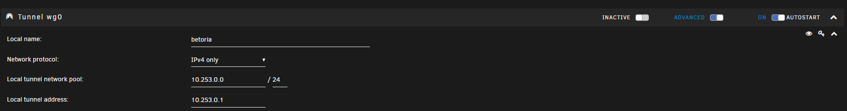

I noticed after setting things up this active/inactive switch doesn't stay "active"
and noticed similar messaging on the dashboard.
I initially thought that just meant "no one is connected yet".
