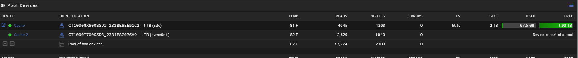

I replaced the cable, cleared my cache error and downloaded new doagnostics. However. I have only had the server up about 20 minutes so I am not sure if the fault takes awhile to resurface.
goodyflix-diagnostics-20240325-1806.zip
Everything looks normal so far.
Did you disable the syslog server? Diags only have the current log.
As for the SMART error, CRC errors are usually a bad SATA cable, acknowledge the current errors and replace the SATA cable, and see if it stops increasing.
