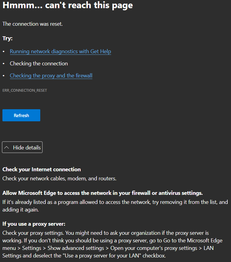

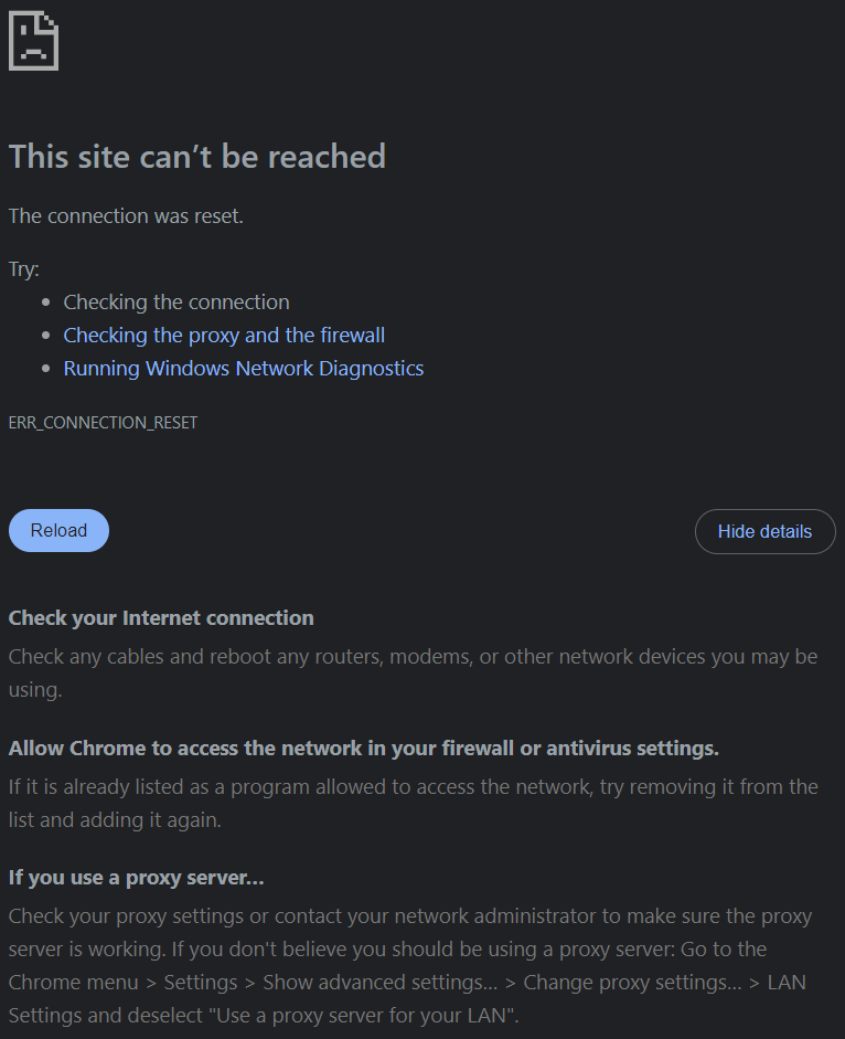

If that does not work,  get a screenshot of the error message that the browser is giving you.  And tell what browser you used in the attempt.
Tried in both Chrome and Edge with the same failed result. Screenshots attached.

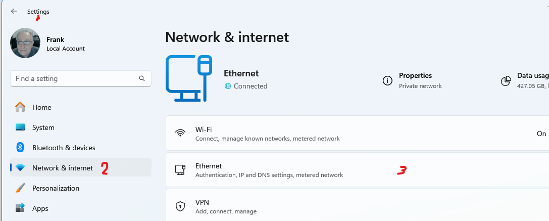

On this Windows computer, go to   Start   >>>  (1) Settings  >>> (2)  Network & internet    and click on (3)  Ethernet
Now look for the IPv4  address and tell us what it is in your next post.    Your server IP-address is 192.168.50.80   This is not an IP address which would normally be expected but it not a issue if everything else is based around it.

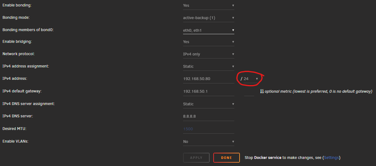

 This was a huge help actually. After you brought this up, I remembered seeing a setting for it within Unraid's network settings. Also before changing anything I checked the IPs of the devices that were working and they were all under .126. I found the setting in Unraid again and changed it. See in the screenshot, I changed it from /25 to /24 and now all the other devices work as well, which have IPs above .126.
