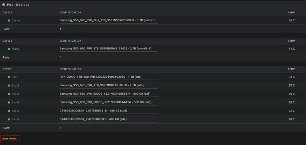

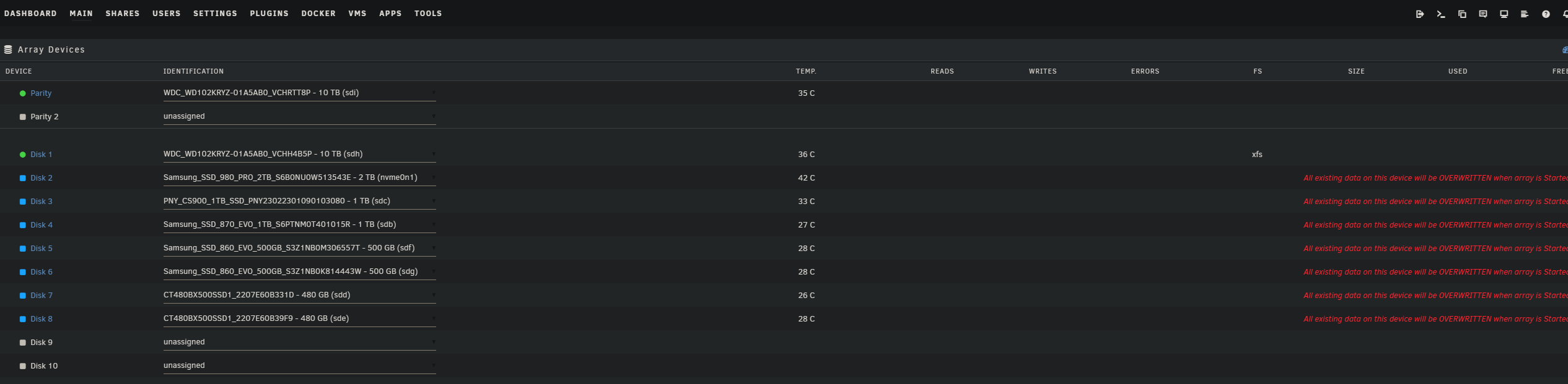

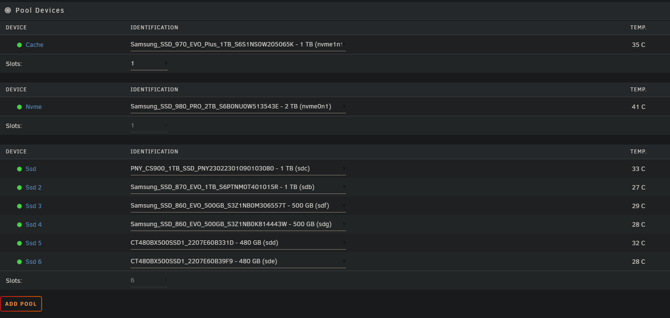

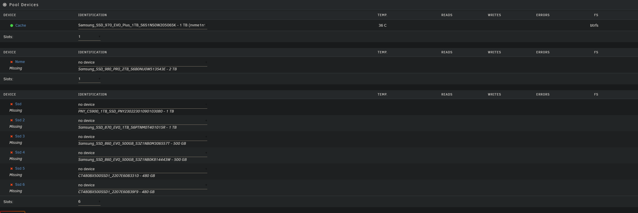

So, just a follow up. I set my unraid array to autostart after a reboot. I captured a diagnostic of before and after restarting. Even though I have it set to start automatically, after restarting it comes back to this view:
To continue and start the array, I have to change Disk 2 - Disk 8 as unassigned, then the pool below will automatically find the drives:
I'm so stumped and not sure why after each reboot the pool drives shows up under the array with the array not starting automatically.

Attached is my diagnostics of before and after the reboot.
memoryalpha-diagnostics-20240330-1609.zip memoryalpha-diagnostics-20240330-1603.zip
From further investigation, I enabled syslog server to capture what was happening after reboot. I also found that there was another post having similar issue. They had to run a parity check and let it complete before it would stop asking for the new drives to be included on reboot, thus allowing the autostart. I'm currently running the parity check. Will update tomorrow when it completes.
Ok, just to update everyone, any anyone else who might have trouble in the future; After completing the parity check, I rebooted the device and the pool and array came back up automatically like it should. So, for anyone else out there, make sure if you add any drives to your server, after setting them up either on the array or pool or cache, or whatever, run the parity check or let it complete before going forward. Thanks for everyone's help. If anyone knows how to adjust the res for the GUI or knows how to correct the efi boot issue, please dm me!
