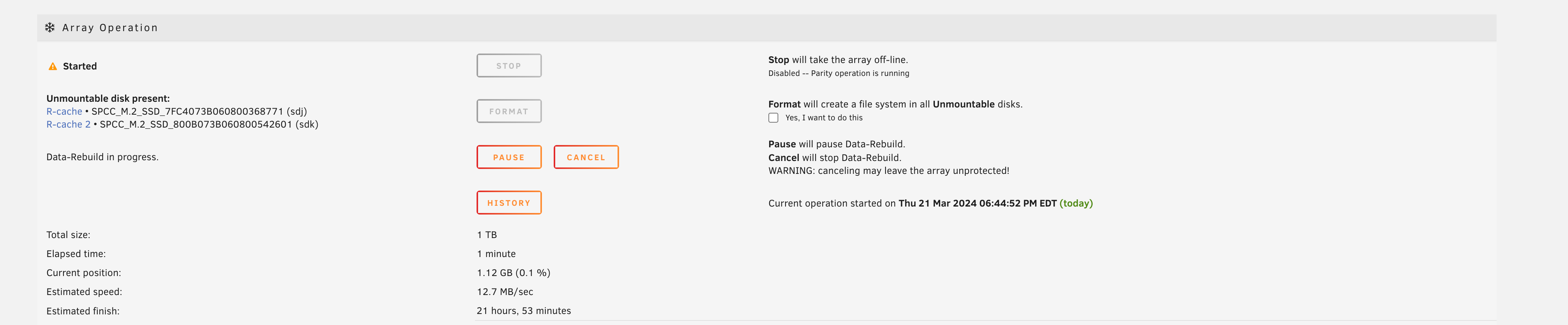

I was very very surprised when I changed the drive and it reported a 12+ Hour rebuild estimate, to wake up this morning to it still rebuilding.

That diagnosis is big. Not sure what to look at, but for fun I am swapping another 1TB drive
21 hours for this 1TB....
