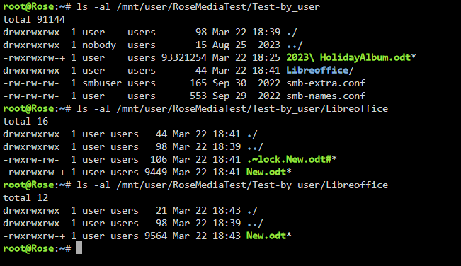

Quick Test:
LibreOffice  7.3.5.2
Windows 11  23H2
Unraid  6.12.8
First test --- copied   2023\ HolidayAlbum.odt   to server  using Windows File Explorer.  Used GUI terminal and   ls   program to verify permissions.
        Permission were   rw-rw-rw-   as expected.
        Opened file by doubleclicking in Windows Explorer.  Edited in LibreOffice.  PErmissions changed as shown above
        Everything worked as expected.
Second test--  Using LibreOffice, New document
                      Than created directory  Libreoffice  using 'Save as' from Writer.
                      Save New.odt in that new directory.
                      Permissions as shown below.  Note they are what one would expect with the exception of the execute bit.
Third test---  Reopened the above file to edit it.  These are the permissions in that state:
                  Notice that extended attributes have been attached when the file was locked!
                  Edited the file and save it. Closed LibreOffice.
                  This is the permissions after that:
I run a series of tests and I had no problems access the directories using Windows Explorer.  I even opened the New.odt with an E-book reader and that was successful.
Third test-- I  opened this file using Windows Explorer from another computer logged in with different user-name.  Edited the file and saved it.
                 Here are the results from that test:
So you see that Libreoffice does work with Unraid SMB.  The fact that there are extended attributes on LibreOffice edited files does not seem to impact normal usage of these files.  I have no idea why your dad is running into issues.  But I would suspect that it is something in the way that his Windows computer is set up.  I will ping @dlandon as he does seem to have a bit more knowledge in this area.

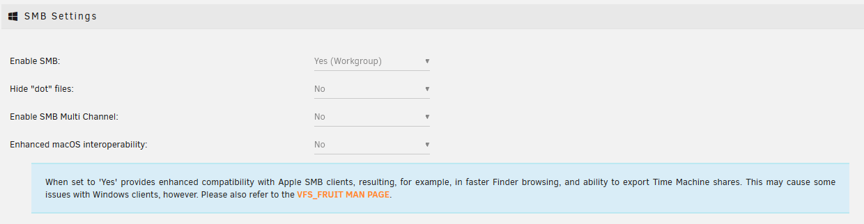

I don't know if this is important, but to improve the SMB performance under macOS, I added these lines under Settings --> SMB Settings --> SMB Extras:
veto files = /._*/.DS_Store/
aio read size = 1
aio write size = 1
strict locking = No
use sendfile = No
server multi channel support = Yes
readdir_attr:aapl_rsize = no
readdir_attr:aapl_finder_info = no
readdir_attr:aapl_max_access = no
fruit:posix_rename = yes
fruit:metadata = stream

I don't either but there is a warning here:
And here is a link to what those lines are doing:
     https://www.samba.org/samba/docs/current/man-html/smb.conf.5.html
By the way, if you put a    #     in front of any line in SMB Extra settings, you will convert it into a comment...
I have no experience with Apple products so I am no help there at all.
