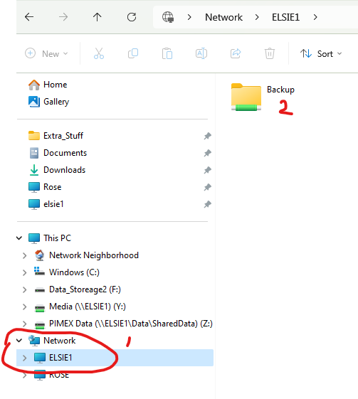

2 hours ago, Frank1940 said:
going in from the server name and drilling down?
I mean starting from here in Windows explorer:
You can even do this when saving a file from LibreOffice the first time.  (You may have to do a bit of exploring in the 'Save As' dialog in LibreOffice to find the server name.)
You can also create a shortcut to the exact location in Windows Explorer when your dad stores his files.  In the first post in this thread, look at the file named "An Alternative Method to Network Neighborhood.PDF"  for a more complete explanation on how to so this:
    https://forums.unraid.net/topic/110580-security-is-not-a-dirty-word-unraid-windows-10-smb-setup/#comment-1009109
Be sure to give your shortcut a descriptive name so that it is instantly recognizable.
