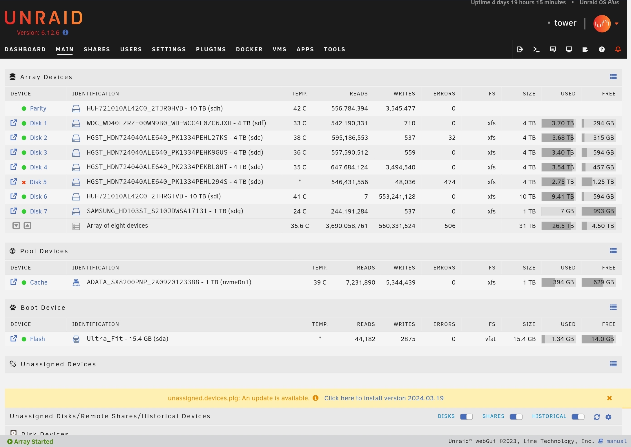

Here's my dashboard now
Will shut down and check cables when I get back to the server in the next couple hours.
1 hour ago, pendo said:
correct procedure in getting it back into the array, as it started a complete rebuild.
It would have started the rebuild after you reassigned the disk, or assigned a replacement.
That is the correct procedure. It was out-of-sync. It was disabled because a write to it failed and it had been emulated since then. That failed write and any subsequent writes to it were emulated and rebuild is the only way to recover those emulated writes. The only other way to get the array back in sync is to New Config and rebuild parity, but parity was not the problem.
Not clear the rebuild completed, but it might not be noticeable if you rebuilt to the same disk because any sector it hadn't rebuilt yet would still have whatever data was there before and maybe it was OK.
