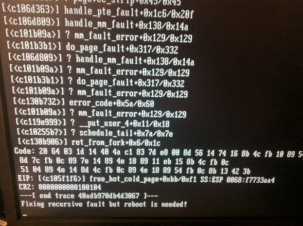

Also i got this message when i rebooted. I had to reboot twice for the system to come back
