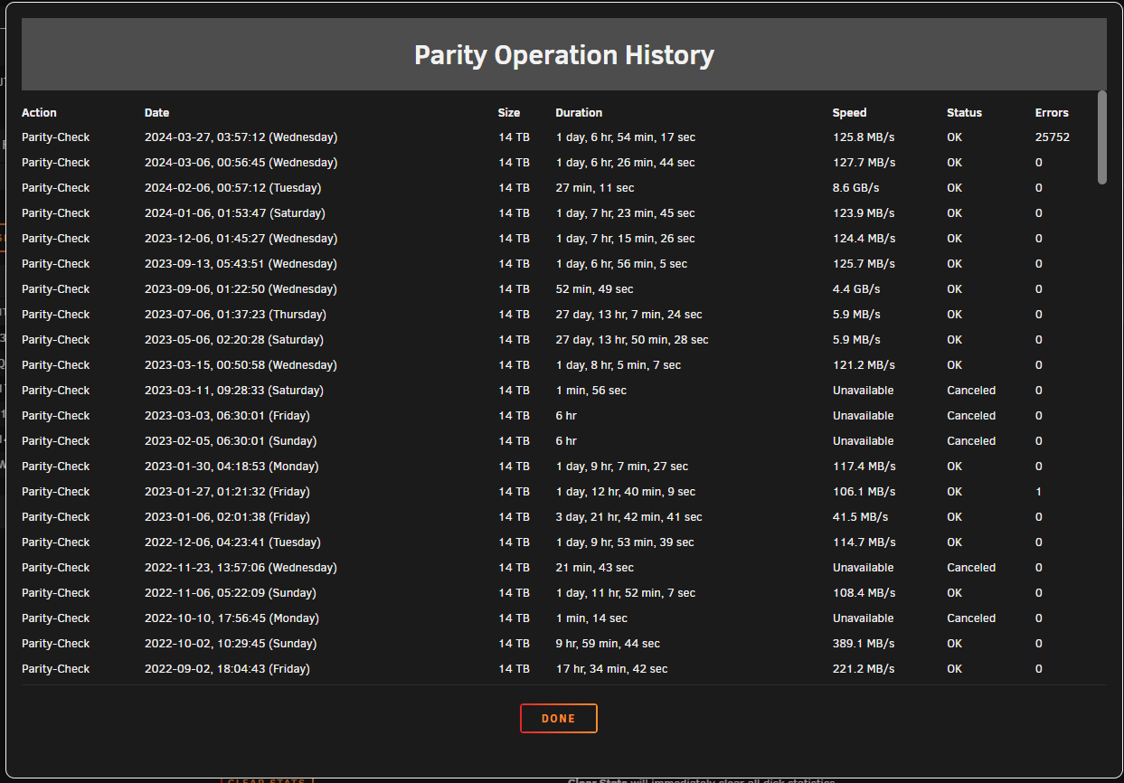

Parity Check completed and I got an email when it finished indicating that there were 0 errors??  I have attached a current diagnostics.  I also attached a screenshot of the parity history that shows the zero errors and the sync errors that were corrected.  There was also a second email that read as follows...(what is error code -4 listed after the sync errors):

53 minutes ago, goinsnoopin said:
Last check incomplete on Tue 26 Mar 2024 06:30:01 AM EDT (yesterday), finding 25752 errors.
Error code: -4
That seems to correspond with when parity check was paused.
Mar 26 06:30:01 Tower kernel: mdcmd (39): nocheck pause
Mar 26 06:30:01 Tower kernel: md: recovery thread: exit status: -4
Later on syslog says
Mar 27 00:30:01 Tower kernel: md: recovery thread: check P Q ...
Mar 27 03:57:12 Tower kernel: md: sync done. time=12431sec
Mar 27 03:57:12 Tower kernel: md: recovery thread: exit status: 0
