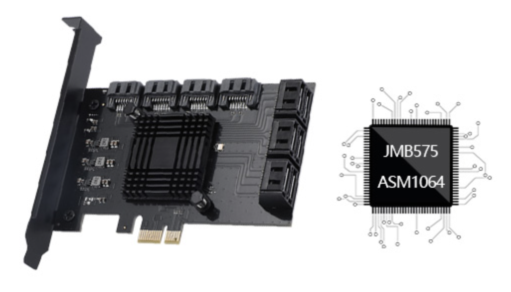

Few weeks prior to the power loss, I added a PCI SATA controller card for ten additional disks. Everything looked good prior to the power loss (but I did not look so closely then compared to now).

Avoid using controllers with SATA port multipliers, more info below:
16 minutes ago, Teffi71 said:
While I am now looking for another card, can I still use the four sata on the top of the card?
You can try, if those are the main ports it may work better, but at least one it will still be using the SATA multiplier.
Once the server freezes up again, I will try to replug the disks accordingly! I will also remove the two extra SSDs. Then I should be fine with the total SATA slots until the new controller arrives.

  • Broadcom LSI 9300-16i SATA / SAS HBA Controller RAID 12Gbps PCIe x8 Avago IT FW Refurbished
  • 4 x miniSAS auf 4x SATA Kabel SFF-8087 0,5m
