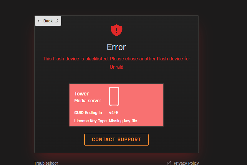

hoping someone can help, server has been working fine but now I'm unable to connect to the gui at all as i get error connection refused. All that I think might be related is that I was trying to connect to unraid connect last night and couldn't because the usb was blacklisted.
I have a new key ready to go but obviously I cant access the gui to update it. I also don't have ssh or telnet etc enabled, I have cleared the network config from the usb, put a new install on a replacement usb, cleared my port forwarding, tried safe mode and it even shows the ip when I connect a monitor like normal yet it wont connect.

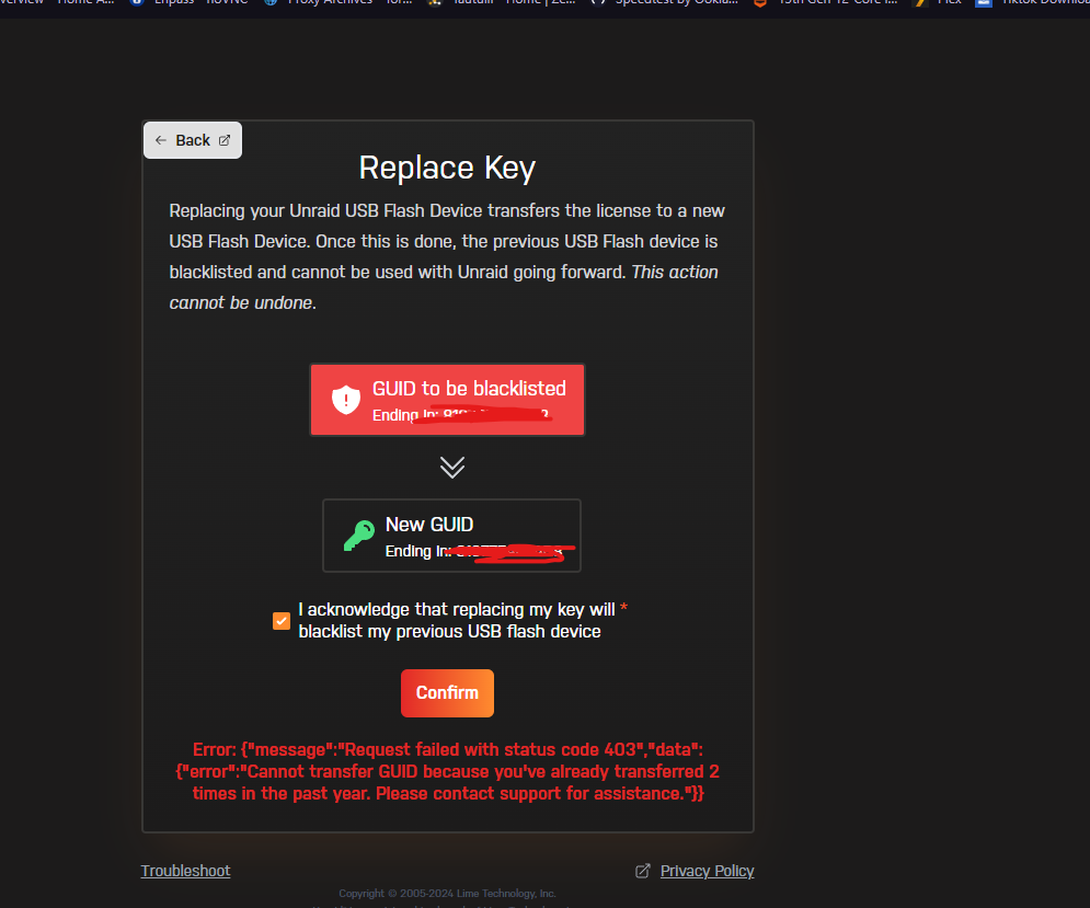

Tried as suggested my Trurl but the original usb is blacklisted so that's now not going to work89600058_Screenshot2024-03-26194629.png.c93f94ac0374b8cc65b57c46795d3062.png work

Doesn't matter what way I try it it fails to either replace the key or recover it, the current usb was blacklisted before all this happened as I noticed it last night whilst trying to connect to unraid connect. I have also emailed support.
Its all a bit confusing because at the start of the month the usb failed so I changed it etc, I ended up getting confused with what one was which as all my unraid usbs are exactly the same. Then the server was fine though so I just left it, It was only last night that I had this problem with it refusing to connect and then remembered the old usb was blacklisted etc.
Hopefully support can help even though I've had more than two keys this year unfortunately. Defo need to get ssh and/or telnet set up but that's its own problem lol.
