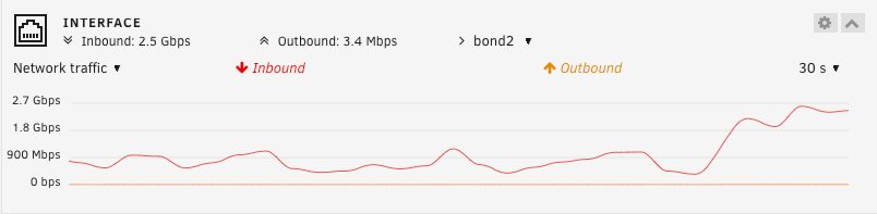

I did set it up on the main array, now changed it to the cache, and invoked the mover, that is not a quick action.

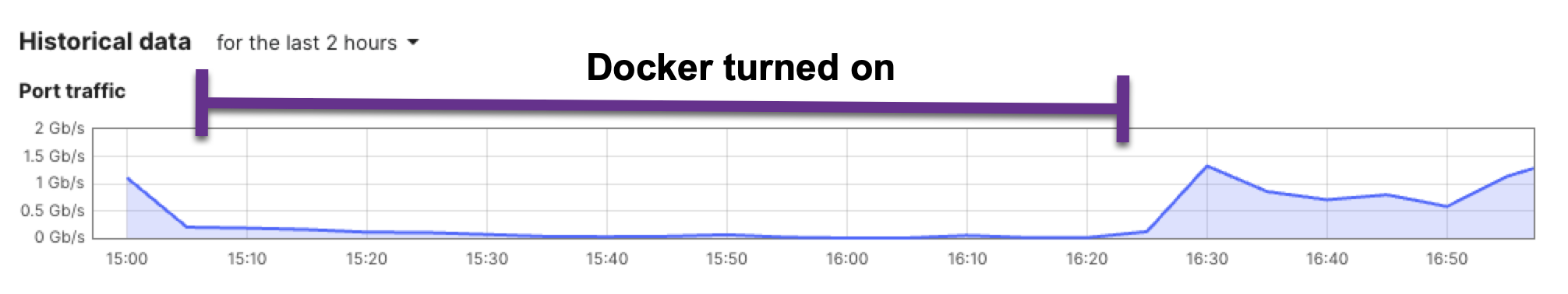

When I spun up the docker containers, while the system was on the array, the network performance dropped. When I stopped Docker to move the share, the network recovered.
I have a few rsync's running moving data back to this server from a backup. I am (10GE Attached) getting a peek of 2.7Gbps (on unRAID screen and 1.4 on my switch) with docker off, and drops to 120Kbps with it on (with the system on the array).
Would this be expected?
once the mover moves appdata and system to the cache (dual 1TB SSD) then I will try again, but curious if this is a known situation.

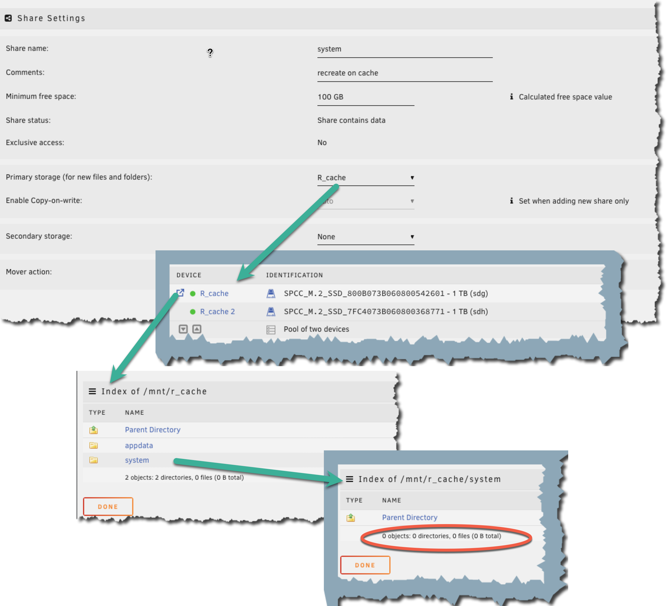

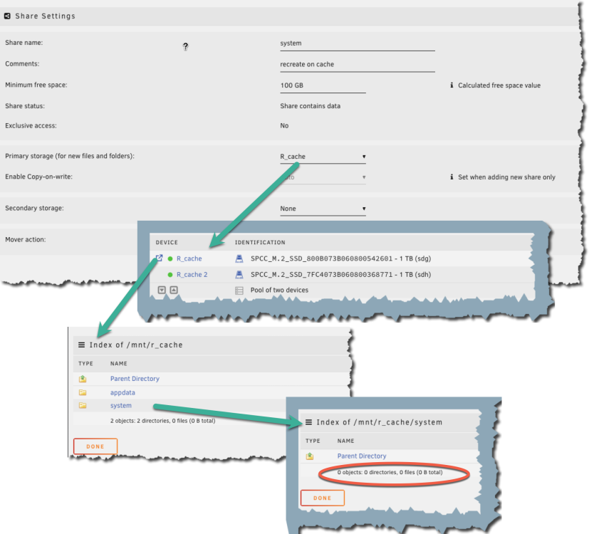

- created a share 'system2'
- move all the files from system to the new system2 (used MC at the CLI)
- destroyed share, created share system on the cache (system)
- moved data back from system2 to system

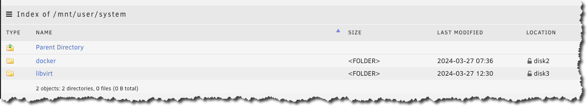

Now I am totally confused.

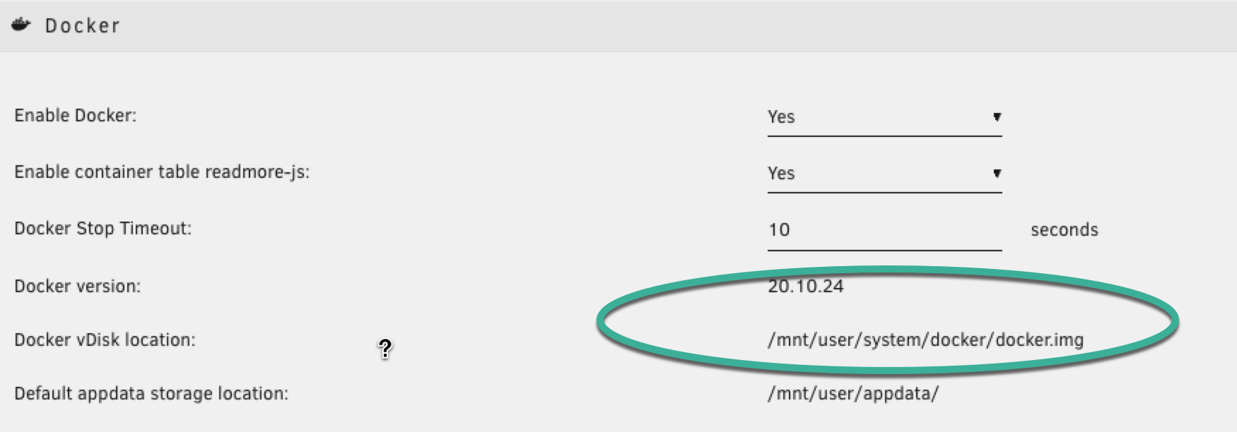

1) Docker is set to
/mnt/user/system/docker/docker.img
2) that share is on the cache, but has no files?

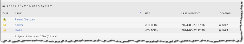

3) If I navigate to the share and look at the files, they are on the array, not the cache
Appreciate the help, I will keep pocking at this.
I will, and I found the problem.
When MC is used to move a directory in this casespacestation-diagnostics-20240328-1026.zip
/mnt/usr/system/* -> /mnt/usr/system2/
Even though system2 is on cache, the files do not move. (just tested it with my trouble shooting)
If I Copy them, they do actually appear on the Cache.
