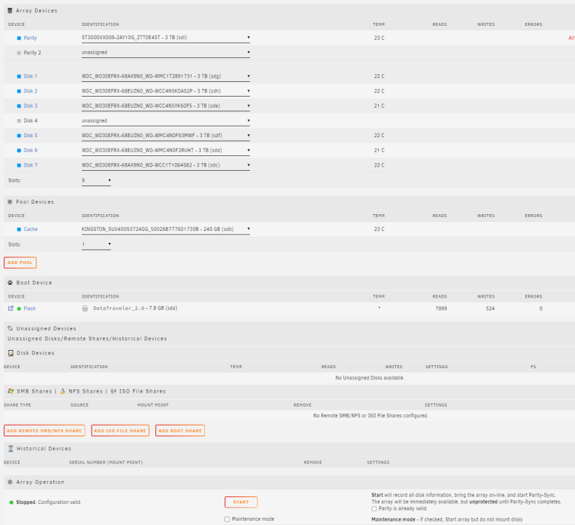

So I have a 7 x 3TB disk array with 1 x 3TB parity and 1 x 250gb cache.
One of my drives failed yesterday (D6). So I did an extended smart report (attached) and because it was giving a WRITE FPDMA QUEUED error, I thought I'd try stopping the array, reseating it, un-assigning the failed drive, starting the array, stopping the array again, reassigning the "failed" drive and starting the array again.
This failed 49% though, so I was in the process of getting a different drive when another drive completely failed (D3) and with the server being in the cellar and me having to lift a hatch and crawl to the server, I thought the drive must have just been having a paddy so I lazily and stupidly rebooted the server. Now I (expectedly) can't start the array as I have 2 drives and only 1 parity.
Am I correct in saying I need to go to Tools -> New Config -> Preserve current assignments -> All -> Done and then un-assigning the failed disks (D4 + D6) and starting the array again, then after the new drives have precleared fine, adding them into the array?
I know I'll have lost all the data that was on D4+D6 but c'est la vie, there's nothing I can do about it now.
TIA.

Looks like you must have already done New Config
I did yes. I did "New config" then second guessed myself before I commited. Lol

Pre-reboot would be better, but these allow to check SMART for both disks, which does not look great, but most data should still be salvageable, re-sync parity and see if you get any errors from both disks.
So I just tick "parity is already valid" and then start? I can't add D4 as it's completely dead. It's clicking and I've taken it out and even Windows picks it up as a "Unknown drive"
First post mentions disks 3 and 6 failing, but if disk 4 is missing, parity is no longer valid, you can sync instead with the remaining disks, and then see if you don't get read errors from disks 3 and 6, or others, all data from disk4 will be gone, if other disks have read errors during the sync you could lose some more data, and based on SMART, it's very possible.

My apologies, I did mean Disk 4. So I leave "Parity is already valid" unticked and then start it up?

If you want to "fill the gap" where disk4 was by changing the assignments do so now, then
While parity is rebuilding, on Main - Array Devices, you should see lots of Reads from all assigned data disks, lots of Writes to both parity disks, zeros in the Errors column.
If it looks like there are problems, post new diagnostics.
Well I'll be replacing disk4 shortly so it won't be an issue.
0 errors in Array Devices so far (6.2% in) but disk 6 (the original one that I was in the process of replacing) raw read error rate is going up intermittently.
