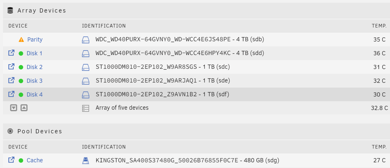

but until then i have connected my HDDs as following :
( i know i'm using green HDDs, but all of these HDDs are brand new )

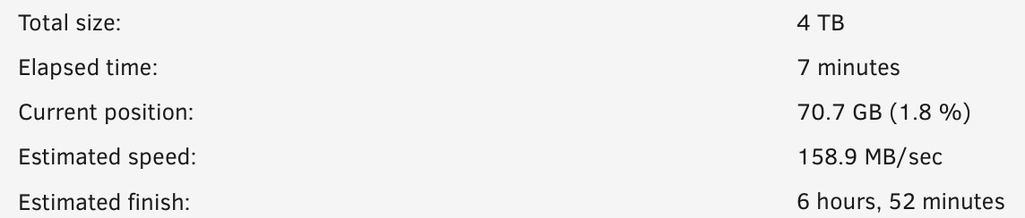

parity sync takes too long (2 days, 8 hours) with speed of 20 Mbps . which is very slow. I have attached the diagnostics. can you please help me diagnose what is the issue and how can i fix it ?

Thanks A lot @JorgeB ,
I have changed the following settings:
SATA ( from Legacy to AHCI )
Write Cache - Enable ( before it was disabled )
now getting 150 Mb/s
