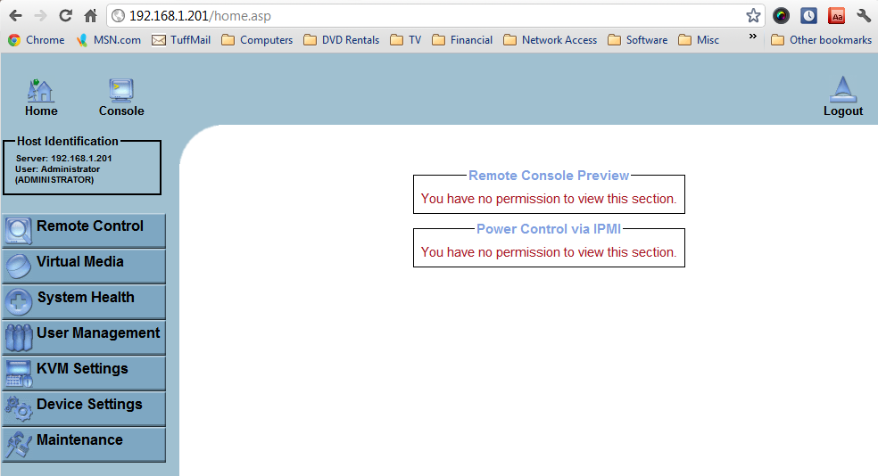

BMC is the acronym for the controller chip(s) used (Baseboard Management Controller).  IPMI is the communication (and more) standards used to communicate with the remote box (Intelligent Platform Management Interface).  The IP address is the IP address setup in the BIOS for IPMI.  Graphic shows access from web browser.  For some reason I've yet to find out - I cannot do anything even though I got past the login just fine.  Don't need this since the Supermicro app IPMIView works quite well.
