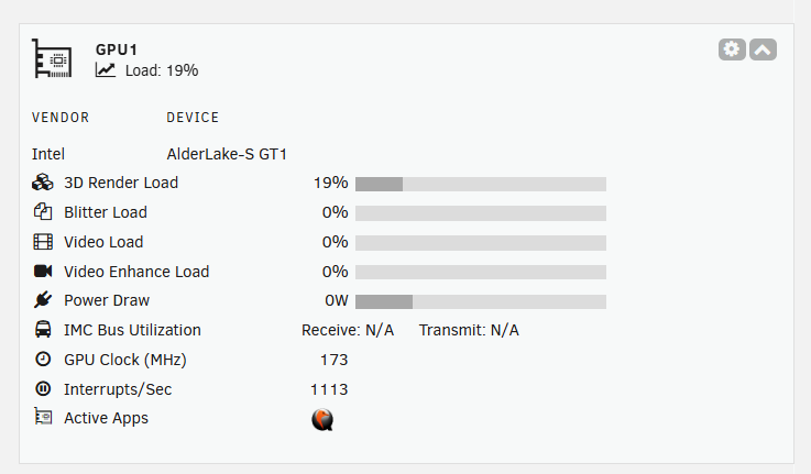

Also will add to gpustat to should QEMU is using the GPU.

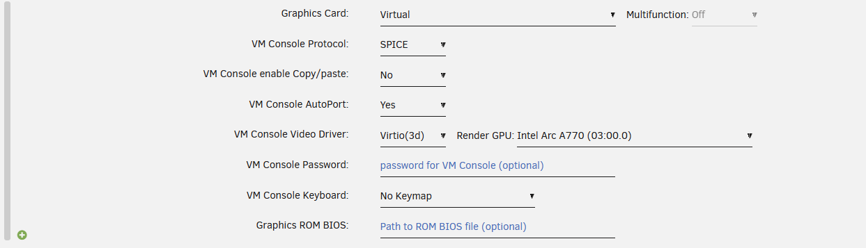

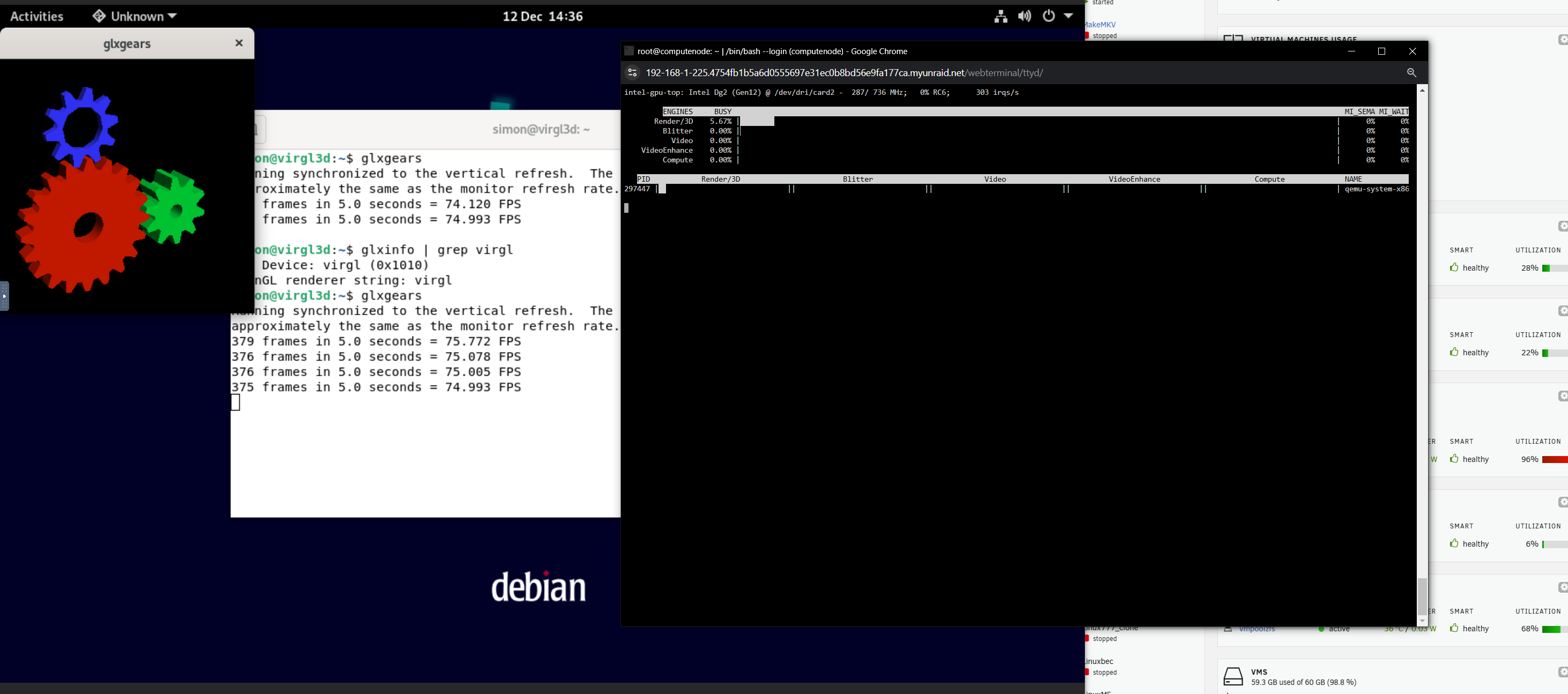

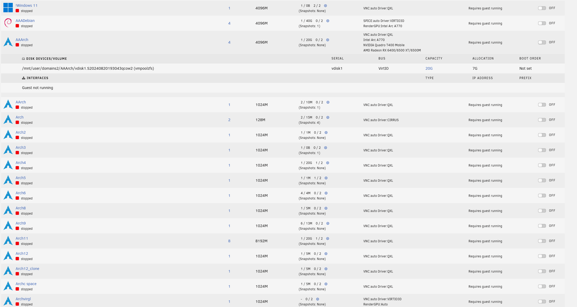

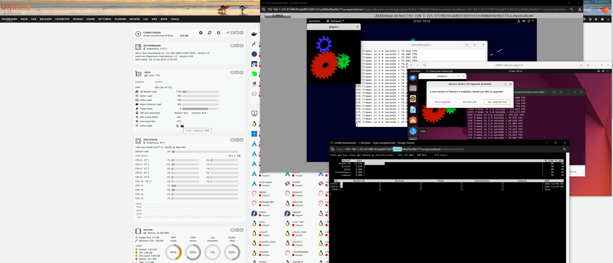

I have working GUI changes and have been testing with two VMs to the same GPU(ARC770) Only support currently in Linux VMs.

Virgl
glmark2 2021.02
OpenGL Information
GL_VENDOR: Mesa
GL_RENDERER: virgl (AMD Radeon Graphics (radeonsi, navi24, LLVM 19.1.5, ...)
GL_VERSION: 4.3 (Compatibility Profile) Mesa 24.3.0-devel (git-9fc8668b66)
glmark2 Score: 542

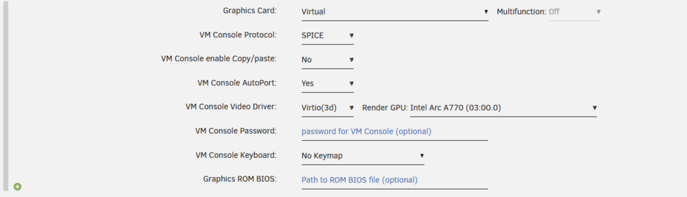

GUI Changes.
Example XML

Drivers and RenderGPU added to VM View.

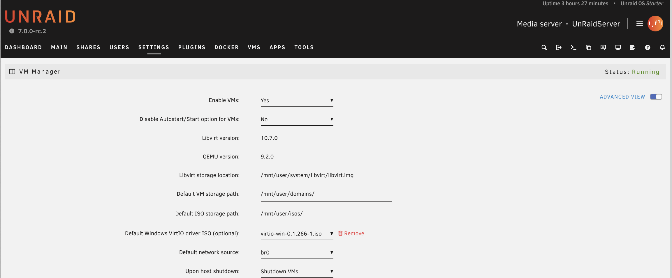

VM Settings should show vers 9.2.0

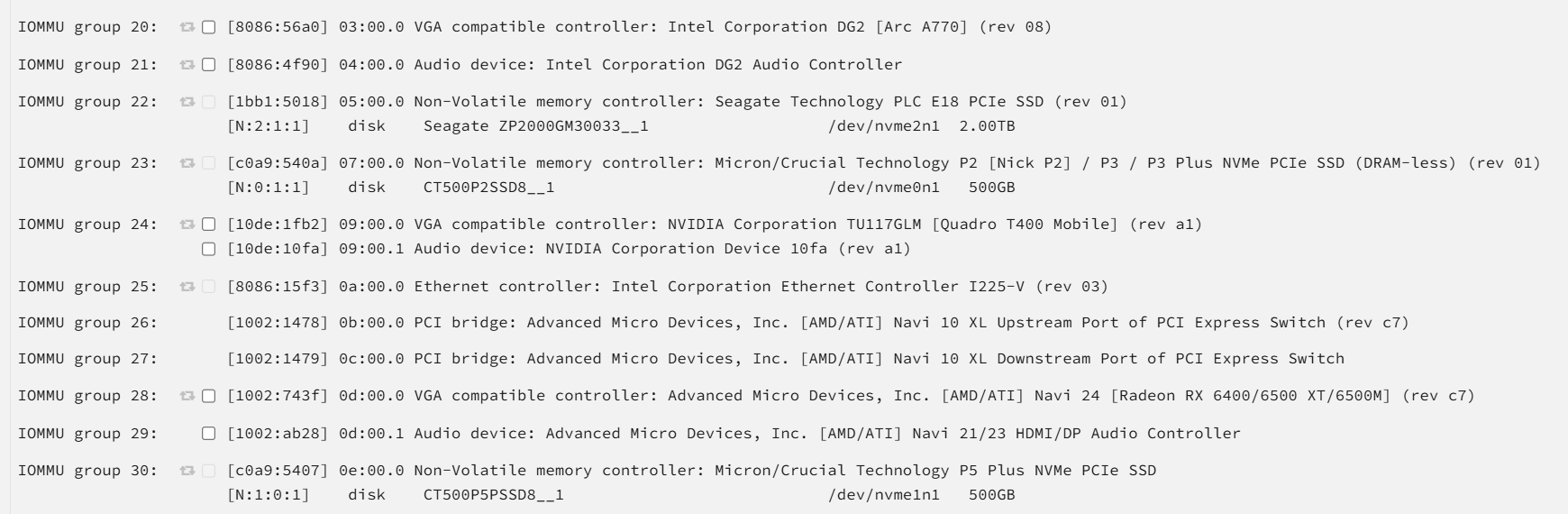

You should not change the existing spice or VNC graphics section.
Add this after the spice/VNC one. Change the PCI ID to match your GPU. You will need to have the drivers loaded on the host.

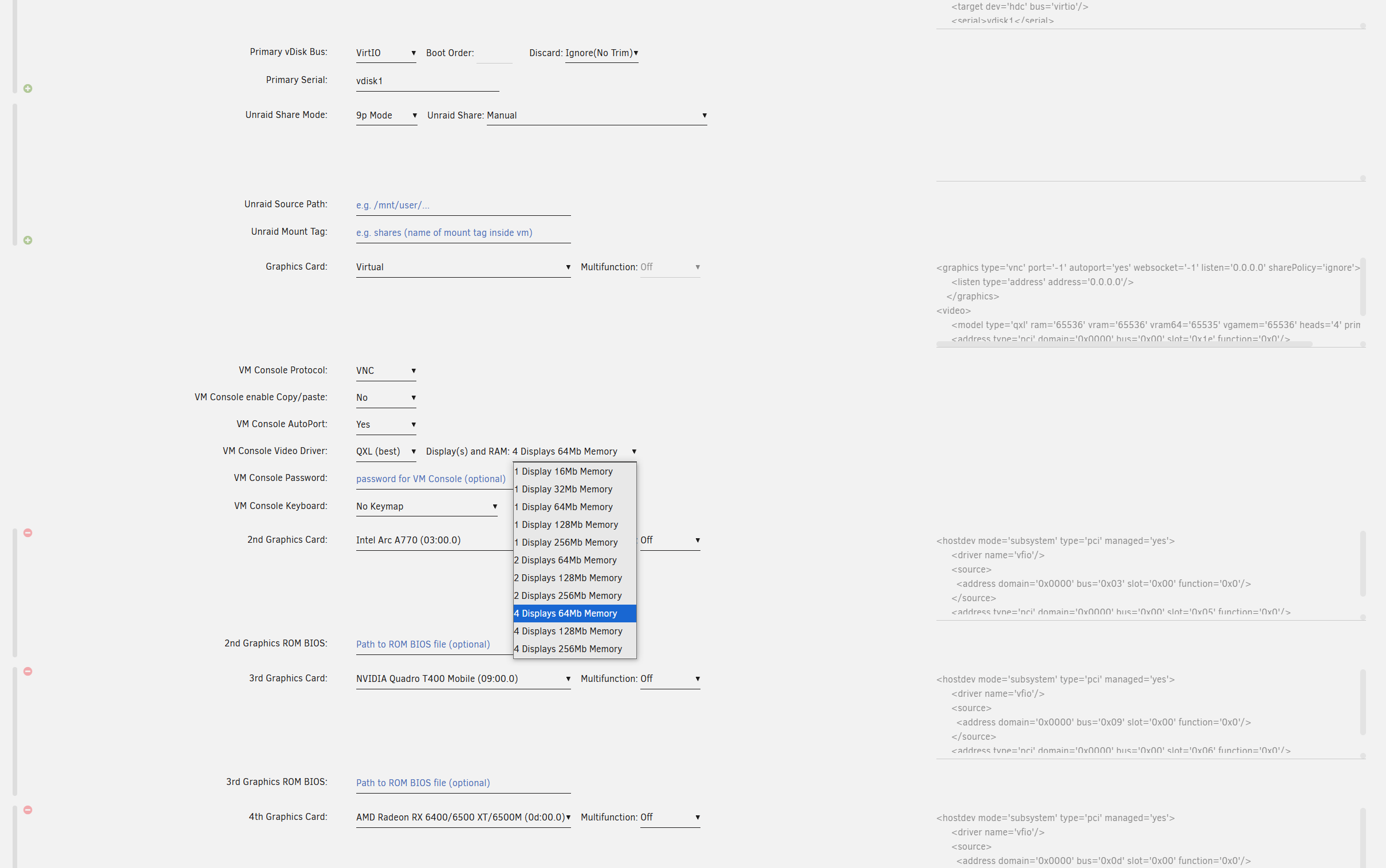

It would be nice to have a VM manager GUI option to increase the video memory for the QXL video driver. The default
is not enough to support high resolutions.
I use
<model type='qxl' ram='65536' vram='131072' vram64='131072' vgamem='65536' heads='1' primary='yes'/>
in my VM config.
Something simple that sets these values appropriate for high resolutions would be a nice option.
I use
in my VM config.
Still looking at options, but propose something like this. Not tested mulitple screens/heads so may not include.

So you have virgl working ok? If running on 7 rc2 the Mesa package is no longer required in extras, just qemu and virglrender.

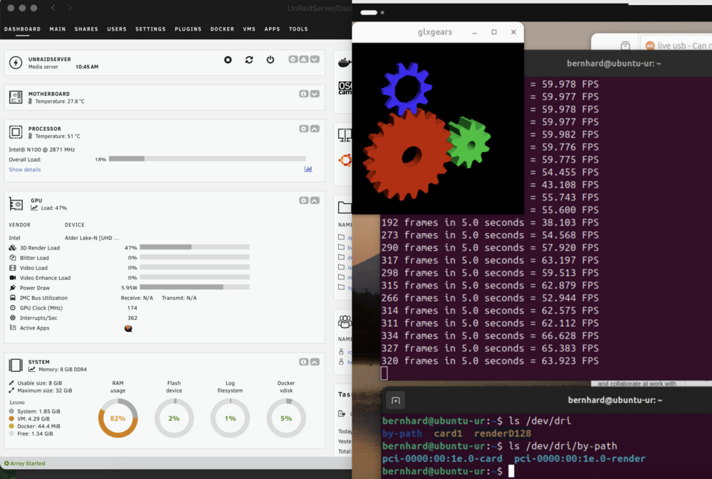

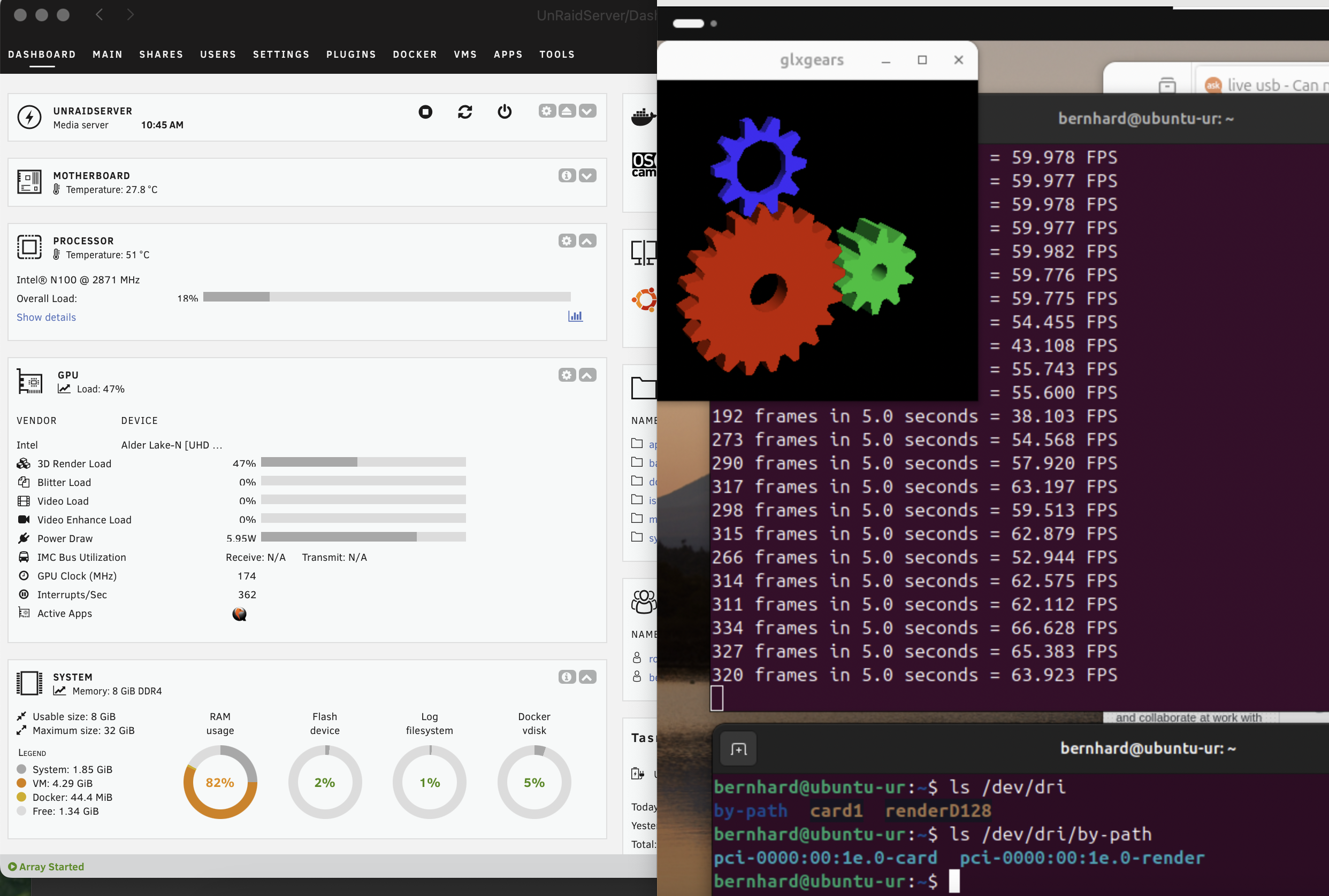

Well it looks indeed that I am still running on SW rendering, the wheels of the gl demo are spinning but just increase cpu load not gpu load. I do not see a *-render device in the vm... I have installed the 3 (ok now 2) pkg's and am just reinstalling the vm from scratch, I will add the lines in the vm xml and install Ubuntu 2404..  I will let you know.
Edited by bernieJo
Looks better now! the solution was not only add one line in xml at video section but replace my section with the complete entry :
   <video>
      <model type='virtio' heads='1' primary='yes'>
        <acceleration accel3d='yes'/>
      </model>
    </video>
....and it is real big improvement in performance of the VM's GUI. Really great! I was in doubt if my new N100 board is the right base für my new NAS for having one or the other VM beside Samba and containers. Now I am convinced.
So looking forward to have it in the Unraid GUI. 😁👍

Would it make sense to separate out the number of displays from the memory, as two independent dropdowns?
Maybe but the back end processing is more simple this way.
