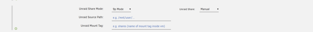

When adding a share through the UI in Unraid VM setup, users currently have to manually mount the share from the VM OS.
The UI makes it seem like this is done automatically when adding the share but this in fact not possible since the setup has no control over VM OS files so mounting the added share from the UI must be a manual step.
A helpful improvement would be to provide a dynamically generated line suggestion within the template that needs to be added to the fstab file when adding a share. Possible example:
# Mount <sharename> share at startup using virtiofs <mountpathinvm> virtiofs defaults 0 0
<sharename> <mountpathinvm> virtiofs defaults 0 0
Taking into account the type of share virtiofs/9pmode and whatever other setting is needed that changes the mount script
This would guide users through the correct mounting process and make this feature a little more polished.
Somewhere in here, near its respective VM would be a nice place to put the info described above

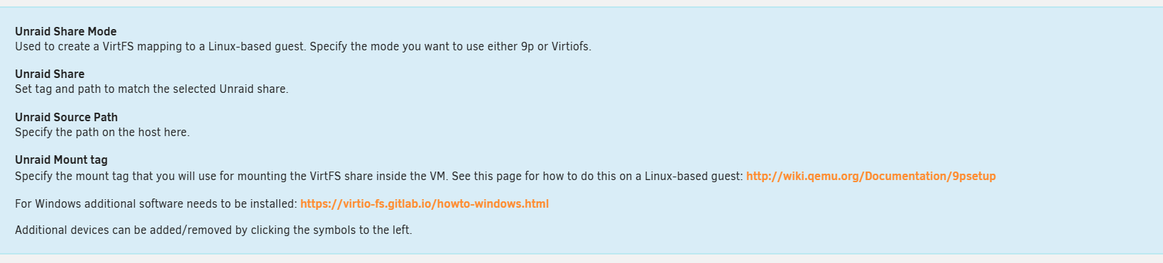

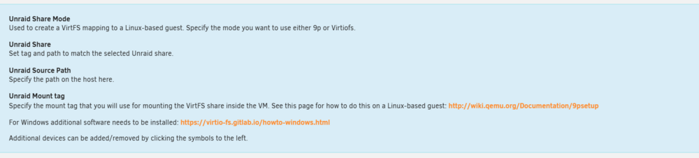

There is some info in the help text will look to expand.
Thank you for the reply, this is indeed helpful, but I still believe what I mentioned could be valuable.
I am having issues with finding the help text that you posted though in the VM creation page, is it somewhere else in the docs?
EDIT: Most of the fields in the other windows have a very useful info icon to explain some of the settings. It would be nice to have that available here as well instead of hunting for the info you share!
(I could be blind but I do not see it on my page)

Click on the ? In a circle top right to show help text

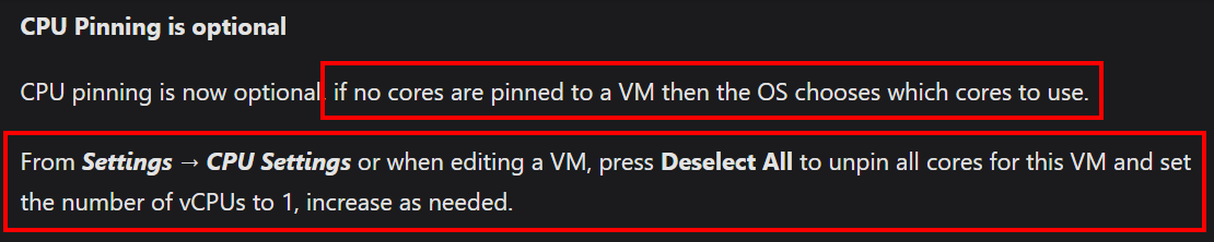

I don't need a individual Core Selection. The Option of this VM becomes 4 Cores, this 8 and this 2. The VM/CPU, ... can handle what Core he actually used.
For People that need a individual Core Selection he can used the actually functionality.
Unsure what you are requesting.

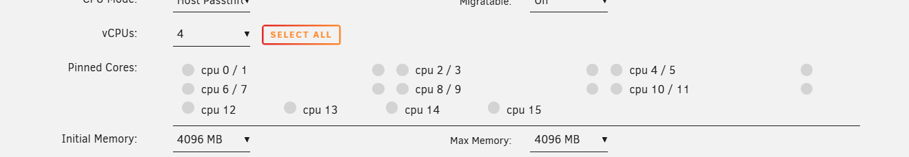

I must selected the CPU Cores that used by VM. For example Core 0/1+2/3 = 4 Cores
I don't type VM used 4 Cores without specific Cores.
Feature was added in 7.1 for this. You can choose vCPUs without pinning.
Than I'm blind. Sorry!
