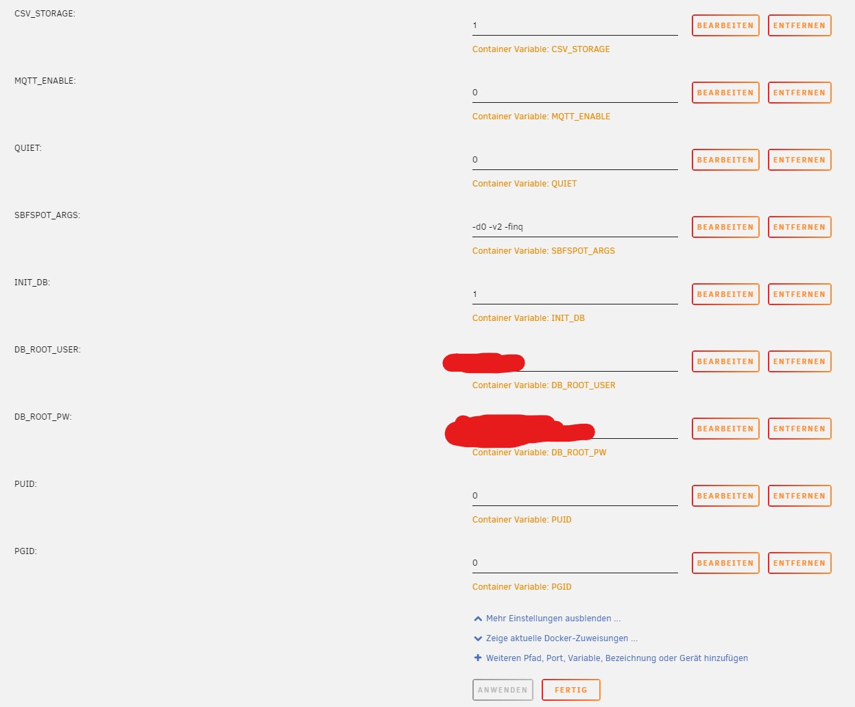

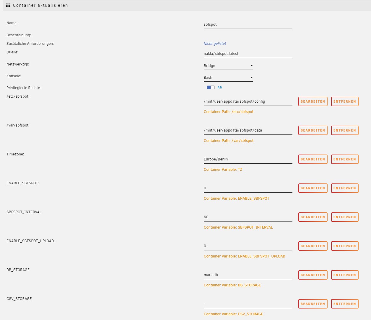

Hi Amane,
many thanks for your reply. I have defined the container directly in the unraid WebUI. Please find attached the screenshots from the configuration.
I compared and adjusted the access rights between both systems but no success.
Kind regards
Holger
OK, finally got it.
I tested a lot and deployed the container with portainer and unraid with the same configs..
The PUID/PGID doesn't work, you need to change this with Extra-Parameters:
--user=99:100 --restart=unless-stopped
