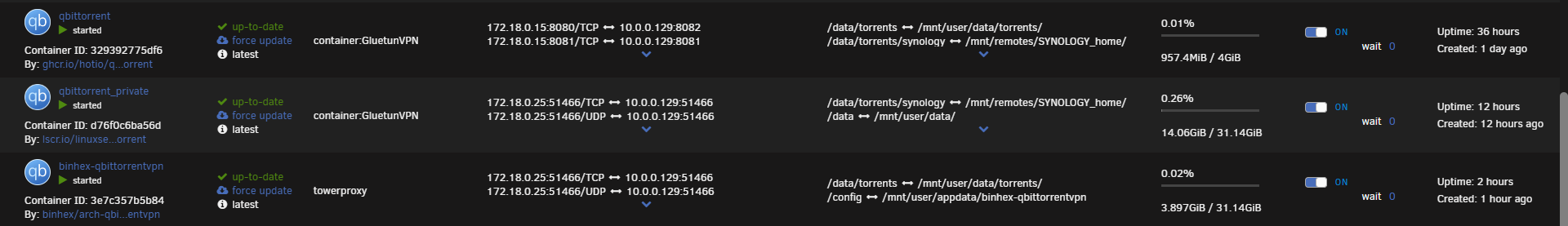

I have an issue where if I leave the web UI of a qBittorrent instance on for too long in a browser tab, it uses all available RAM and crashes the whole server. I can ping the server but not access the Unraid web UI any more or the shares.
I set the --memory flag on the container(s) to limit RAM usage and prevent crashing, but then the instance hits the limit, crashes, and resets itself, which is a problem. This creates a lot of ghost peers and losing upload stats, by not announcing to trackers before the crash.
The middle client has 804 torrents with only a maximum of 8 being allowed active to seed, which is causing the biggest issue as it increases in RAM the fastest out of the three.
When the problem begins by accessing the web UI:

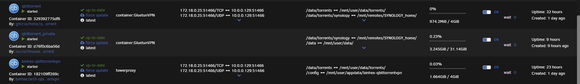

End result just before a server crash (bottom container crashed itself and uptime reset):
Total RAM:
