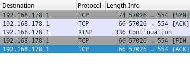

  • I verified with WireShark and a tcp connection on port 554 s made, but the udp connection is missing:
