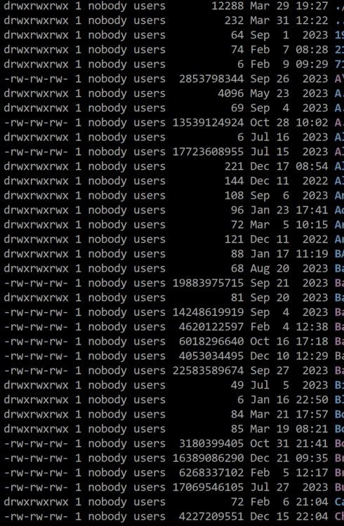

Post the output of:
ls -la /mnt/path/to/some/files/or/folders/that/don't/show/up

Are all files/folders from the list above missing from SMB or just some?
Just some. I've tried to find some correlation between files I can see and files I can't but I can't find anything.
In the list above there is a folder starting with 7.  Date Feb 9. That's the first folder I can actually see in Windows, the 2 folders above that I dont see.
I then don't see any folders until the folder starting with A and date Dec 11.
