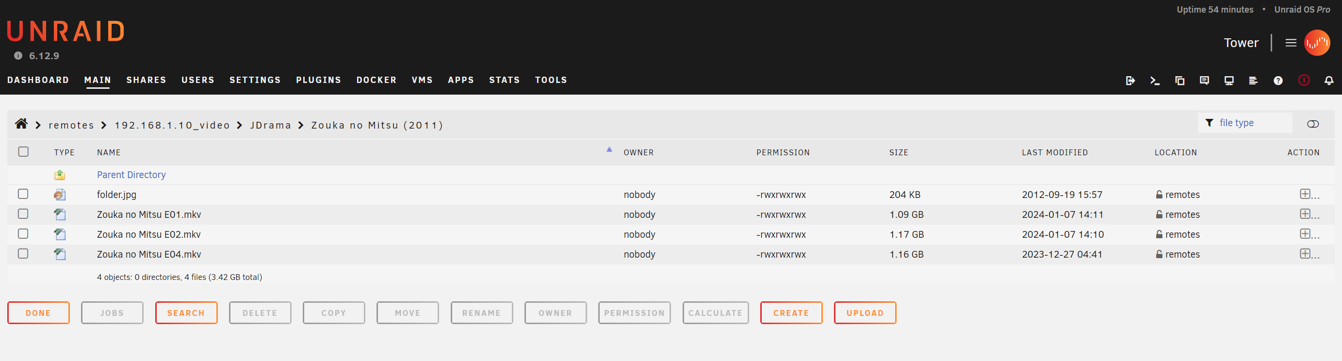

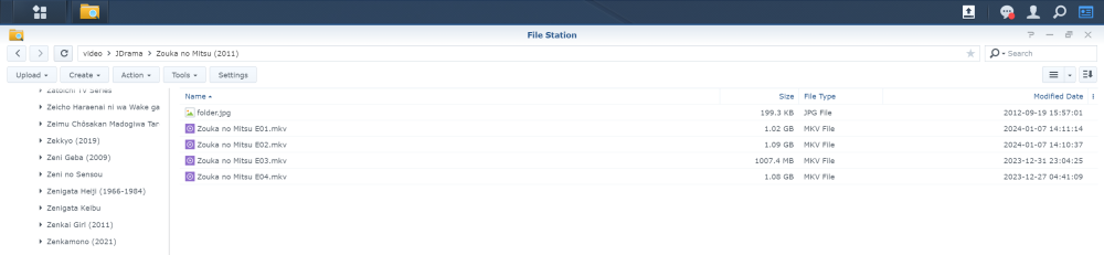

Basically when vewing/listing contents of SMB shares random folders and/or contents of folders are missing. This is with Unraid file explorer, Krusader and terminal. this seems random with no discernable common pattern.267809609_DS1.thumb.png.719f360810b0ea131f7dbc0a599e6f0d.png

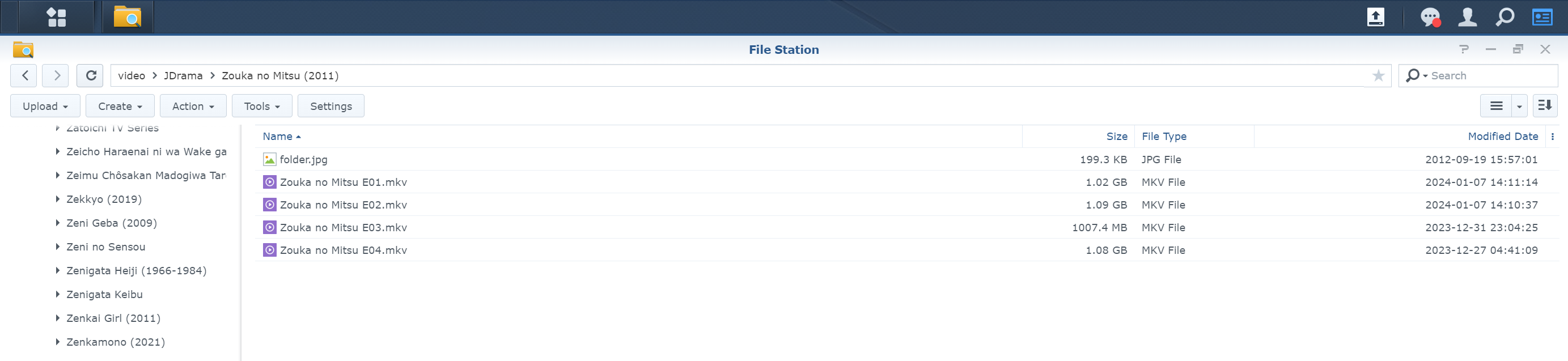

example above - contects of folder - 4 mkv files and one jpg from DSM file explorer

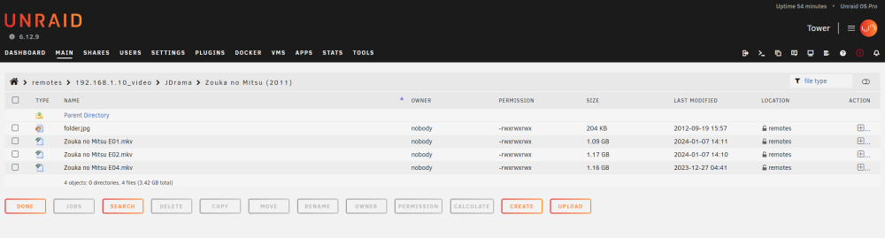

Now on Unraid 400129697_unraidshare1.thumb.png.732e840d0078aeb9d50b836889b9323a.png
Episode 03 is not shown

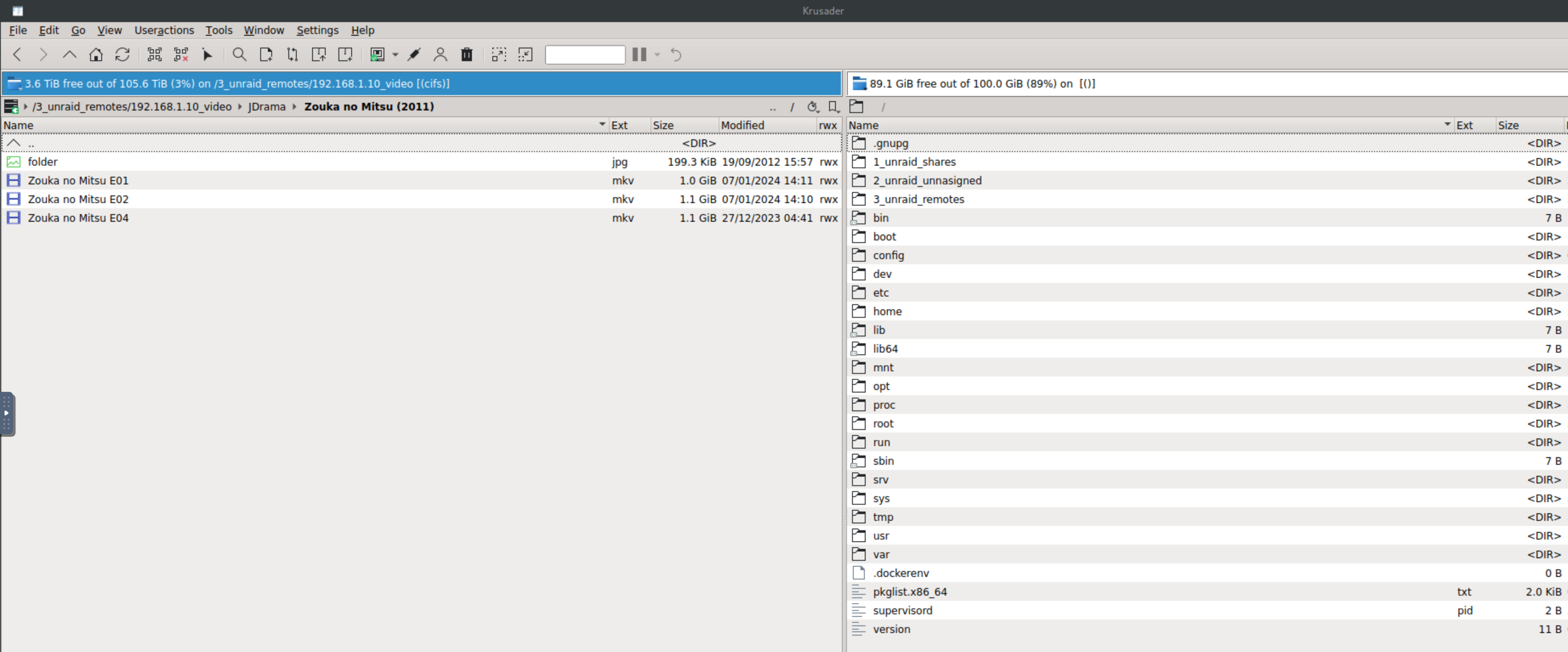

Krusader

root@Tower:# dir "/mnt/remotes/192.168.1.10_video/JDrama/Zouka no Mitsu (2011)"
Zouka\ no\ Mitsu\ E01.mkv  Zouka\ no\ Mitsu\ E02.mkv  Zouka\ no\ Mitsu\ E04.mkv  folder.jpg

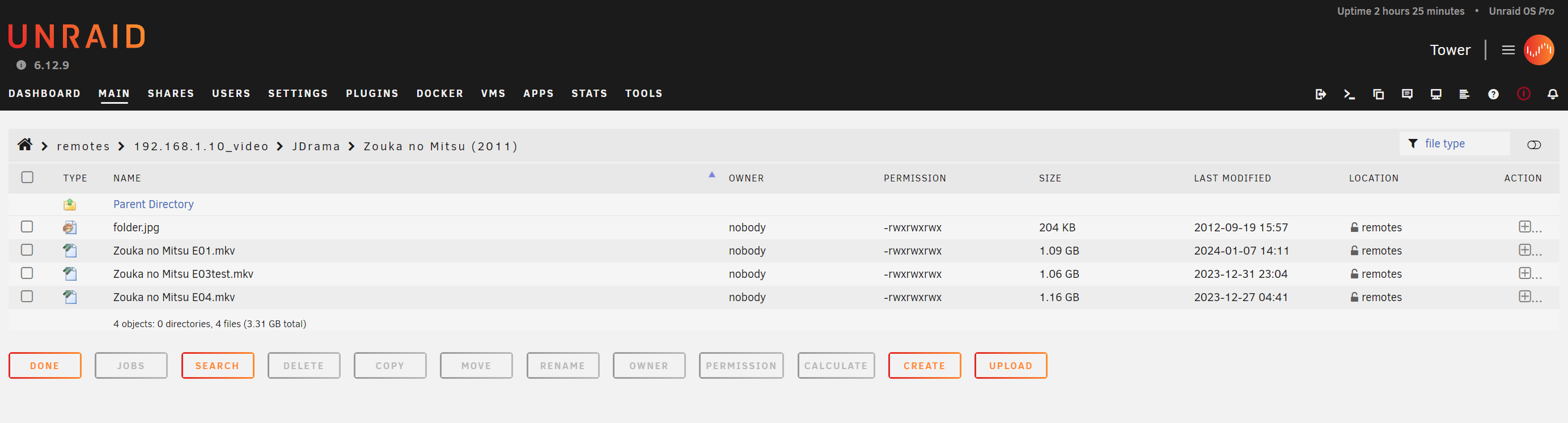

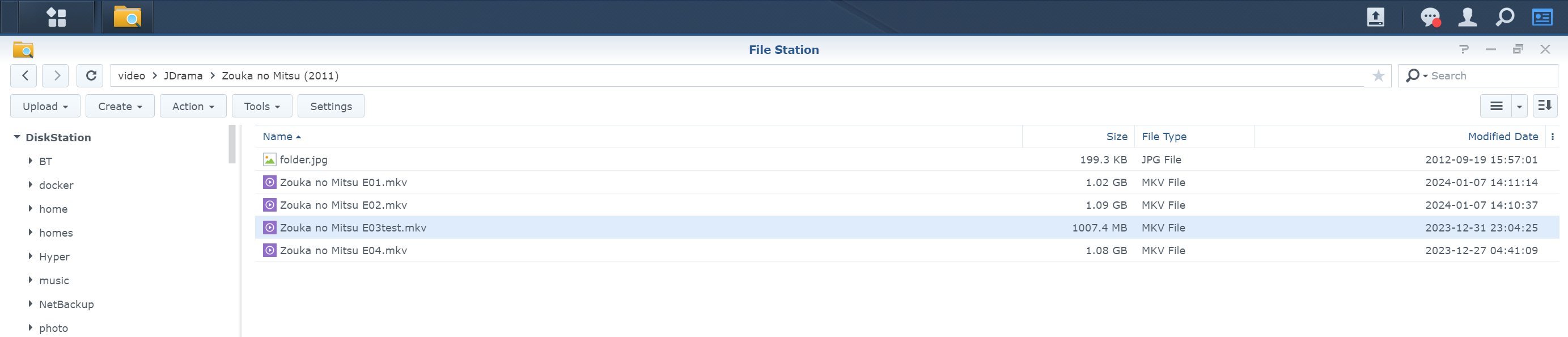

However, if I rename one of the files the renamed file is shown but another file goes missing
I can keep renaming cyclically but only ever 3 of the 4 mkv files will display.
This is just an example of multiple such instances of this behavior.
