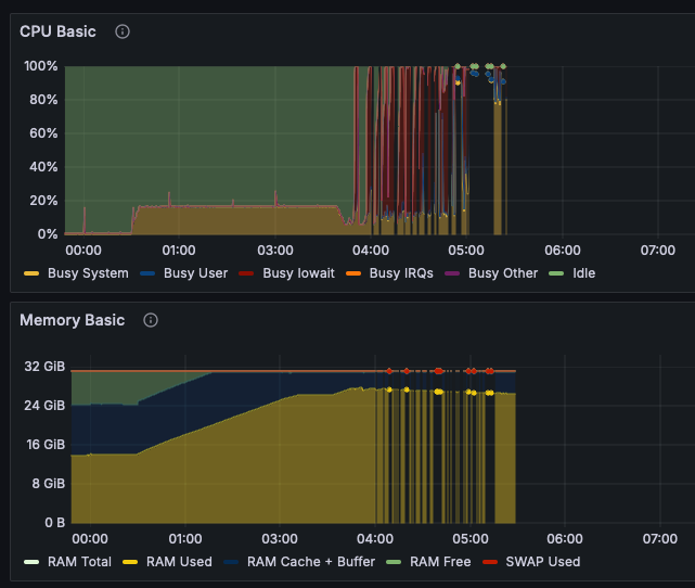

tonight my Unraid server version 6.12.8 crashed, and I had to hard reset it to get it to work again.
Uptime Kuma, running on another system, started to report issues with the first Docker service at around 3:57 AM, continuing until 7:15 AM when every service was unreachable.
My backup script which is supposed to run at 6 AM, that would restart all containers, was also not successful.
At 8:30 AM I checked the server and saw that the WebUI was not reachable, neither was server reachable via SSH.
Only a hard reboot by holding down the power button resolved the issue.
I attached the diagnostics from after the reboot, and the syslog file which was written during the crash.
Note: Tonight was also the switch to DST, which is why there are no logs from 2 AM to 3 AM.
This is what Prometheus recorded tonight:
Any idea what caused this crash and how I can avoid a crash like that in the future?

Try using something like glances or netdata with persistence to see what container caused that runaway increase in RAM usage.
EDIT: Seems it could be immich, try limiting the amount of RAM it's allowed to use
