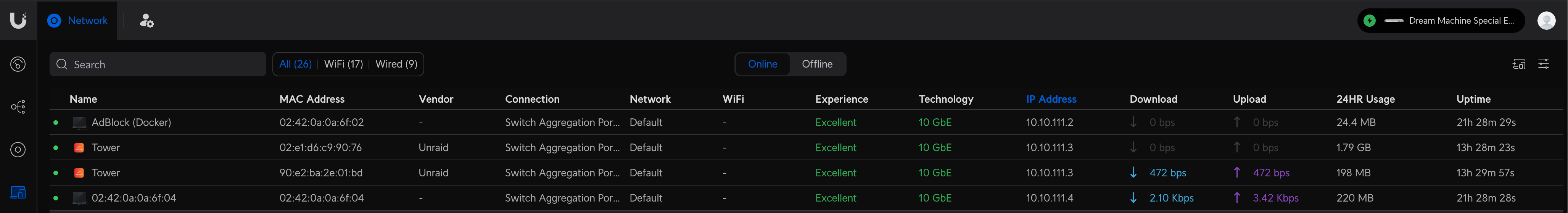

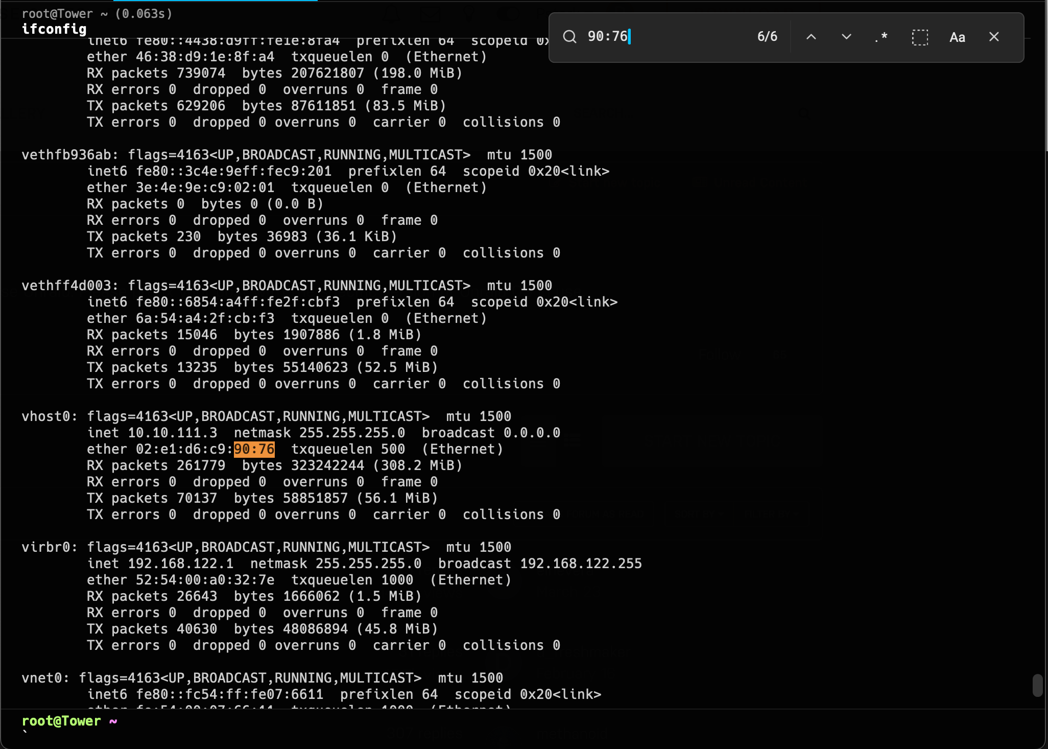

I was recently going to my UniFi Devices list and noticed that Unraid had two lines listed with the same IP address. I am trying to figure out where this MAC address is coming from. ifconfig shows it listed as "vhost0". vhost0's IP always matches eth0 which is the fiber connection I intend to use.

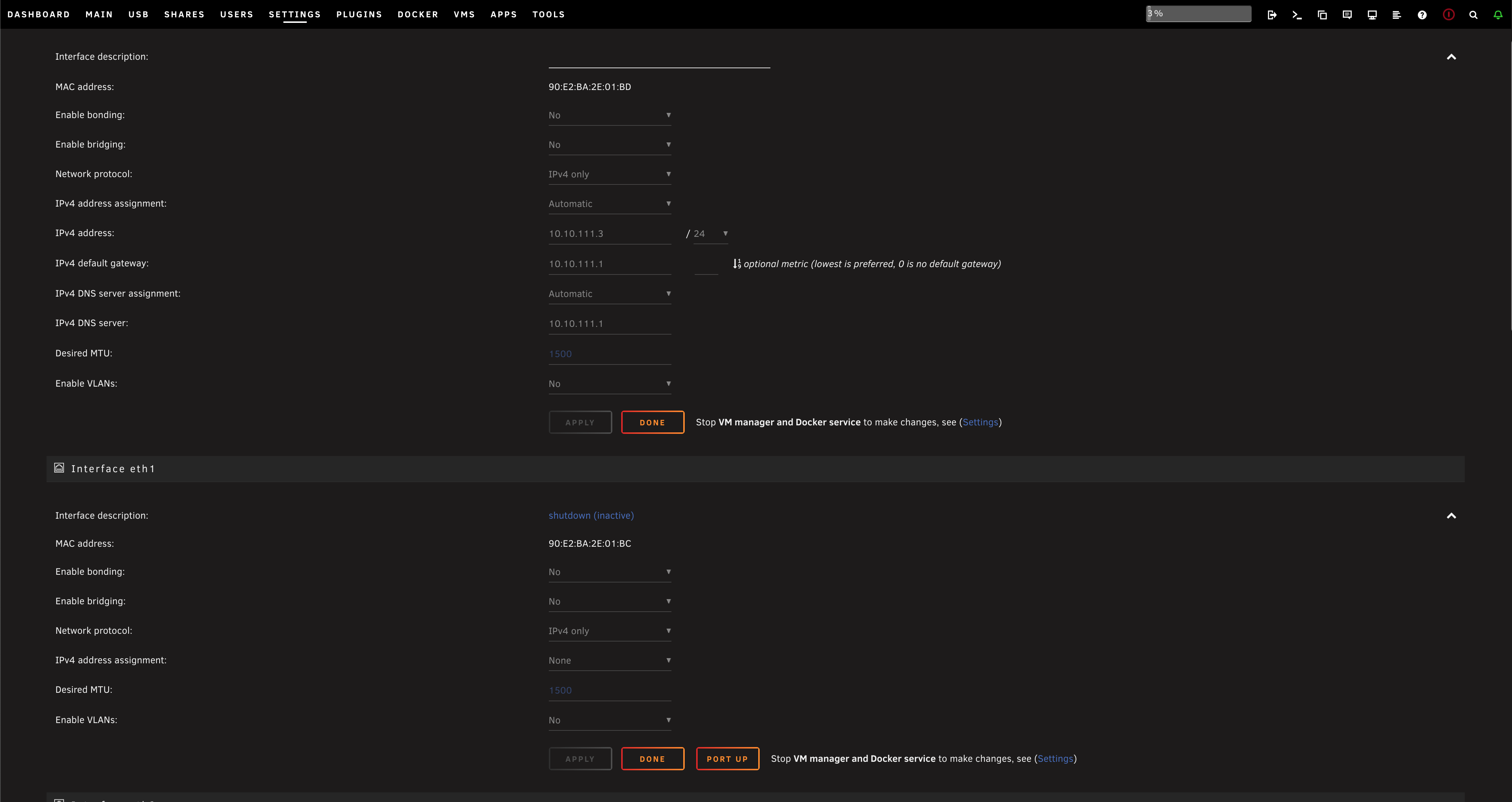

Supermicro MB has three BbE ports and I have a 2 port Intel SFP+ NIC that has only has one fiber connection to the network.

macvlan is the only way docker containers show up in Unifi so I want to keep that. I did enable bridging and restarted eth0 but I still have two MAC address for the server. Before the server had 02:e1:d6:c9:90:76 (unknown mac I'm trying to figure out) and 90:e2:ba:2e:01:bd (mac address listed in network settings) and now I the first one changed to 16:5d:31:7f:75:65 and 90:e2:ba:2e:01:bd.
If I block 16:5d:31:7f:75:65, the UI becomes unresponsive until I unblock it. If I block the MAC address listed in network settings 90:e2:ba:2e:01:bd, it makes not difference.

It's pretty odd that Unraid network settings says the MAC address for the server is 90:e2:ba:2e:01:bd and if I go into my UniFi console and block that device, the server functions normally. But if I block the mystery device that shares the same IP (16:5d:31:7f:75:65) the server becomes unresponsive. Honestly the only reason I'm looking into this is the fact that UniFI Console shows a message that two devices are sharing the same IP.
