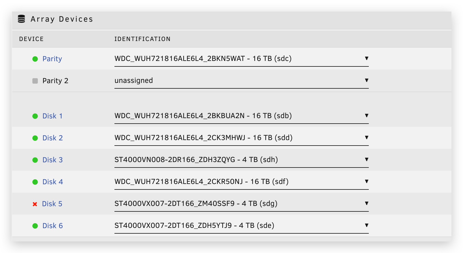

This morning I found my disk5 was disabled.Since I have enough free space on disk4,I decide copy all data from disk5 to disk4 with unbalanced.
Is this a valid way to do or should I try another approch?
Here is my procedure:
  1. copy all data on disk5 to disk4 with unbalanced
  2. stop array and make a new config
  3. make a new array without disk5
  4. rebuild Parity and hope for the best
Thanks in advance for any suggestion.

In theory this will work, but just because a disk is disabled it doesn't mean it's bad. I can't look at the diagnostics right now, but depending on the health of all the disks it may not be the best option.
A disabled disk means a write to it failed, which could be cabling or other issues besides outright disk failure.

I understand,and I did a short smart test on disk5 after reboot and it  `Completed without error`.
That's what worries me.Other 4TB old disks may fail during parity rebuild.Is there any other method you recommend?
My ultimate goal is remove disk5 since its old and I dont need that much space anymore and keep its data.
The Short test is not very thorough.   The Extended test is a better indication of a disk's health.
