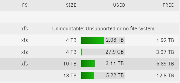

Dredd... I've read some of the other threads on this issue but the recommendation was to make a new thread, so here goes.
I ran my monthly parity-check and after it finished Disk 1 was Unmountable and nothing on the disk is accessble... how can I proceed? It shall be said that I have had some unclear issues with Disk 1 before and had to do xfs-repair, files ending up in lost+found.
Edited by VaartEx
Solved by JorgeB
Check filesystem on disk1, run it without -n and if it asks for -L use it.
That made Disk 1 accessible again ^^ Best practice would be to move all the data to a disk with no issues, right?

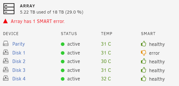

And what about the smart error?
Edited by VaartEx
Run an extended SMART test on the disk, if it passes it's OK for now, if it fails it should be replaced, but it should be OK.
