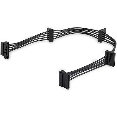

just reading up a bit and now am questioning if this is the source of my problem?
this is how im powering every drive in my case thru a 750w PSU
if this is likely the reason for the issue, can someone recomend me a proper or better alternative to use for 6 drives?
If using SATA->SATA power splitters then you do not want to split a SATA connection more than 2 way as the host end is limited by the current carrying capacity of its SATA connector.   If using Molex->SATA then you can get away with a 4-way split.
