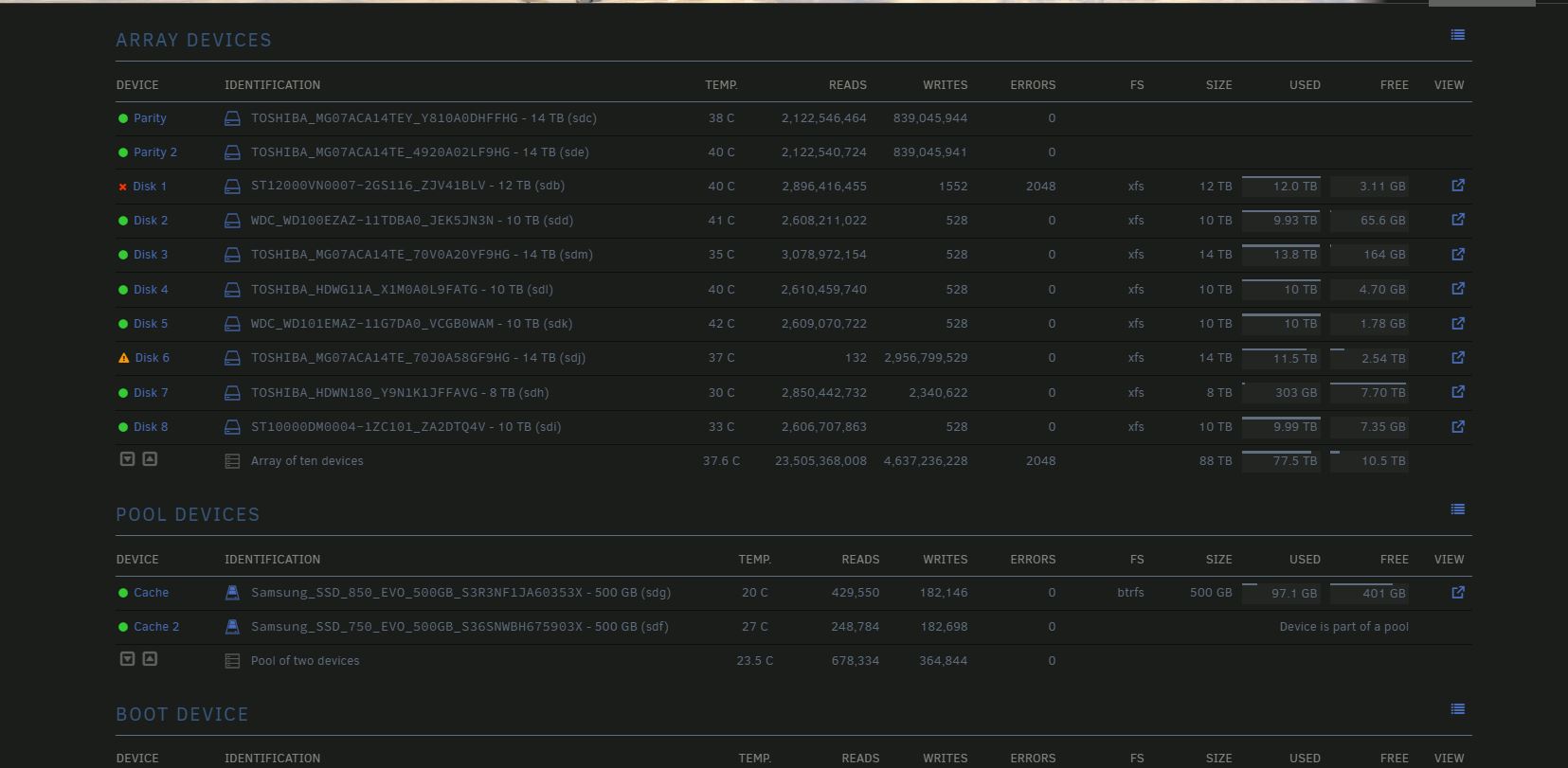

Well heres a dilemma. Running 6.11.5
With hindsight maybe I was asking the box to do too many things at once, but hey
Heres a snapshot of my drive assignments.
I was rebuilding Disk 6 due to replacing and old 8TB with a new 14TB. n(rebuild was paused due to moving some files see below)
I had 2 other drives doing a preclear
I had an SSH session open with Midnight Commander doing a file move
during which Disk 2 went AWOL
at this point I cancelled the 2 preclears and ejected the disks to reduce server load whilst I figured out what to do next. So far so good
at this point I noticed the web interface was not updating disk activity
I refreshed the web interface and it did so but still no change. I can get into other pages on the web interface and I managed to download the logs (see attached)
Dockers seem to still be running
So taking aside why disk 1 failed I figured no problem let disk 6 finish rebuilding and there will be no issue if I have to then rebuild disk 1
alas I can't tell if the parity rebuild on disk 6 is running or not nor when it finishes as the Main webinterface page whilst refreshable doesn't allow any interaction
I've been looking for a way to restart the web interface but doesn't look like its possible on 6.11.5?
My SSH session is still functioning
Ay suggestions appreciated
